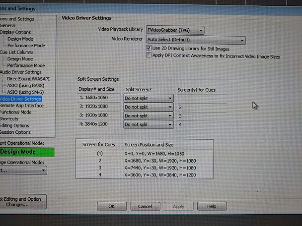

I'm using SCS Pro Plus 11.7.1.3 64-bit with the LAV Filters, and trying to use all the defaults (TVG, etc.).

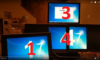

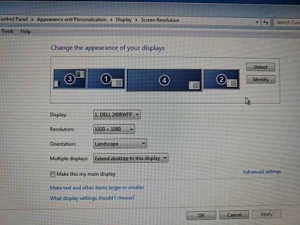

I have four screens (though one of them is actually a "spanned" display using Nvidia's "Surround" option -- basically making two screens appear as one). The displays are:
1. SCS / desktop - DVI out, card 1
2. stage right screen (1920x1080) - DP out, card 1
3. stage left screen (1920x1080) - HDMI out, card 1
4. center screen (3840x1080 "spanned" displays) - two DP outs, card 2
Those numbers are from SCS, and don't match the IDs from Windows, but that's not a big deal.
At first, I had some problems with the video going to the correct screens (and SCS bouncing over to the wrong screen as soon as I opened it), but that was resolved by checking the "Apply DPI Context Awareness" option (even though I don't have any DPI scaling going on, but possibly because of the spanned display).
Anyway, I now have the screens configured properly and test videos (three of them, all H.264 MP4 and sized to the displays) going to the correct places (screens 2, 3, and 4).

SCS Numbering
Windows layout
Physical layout (screen 2 off right)
