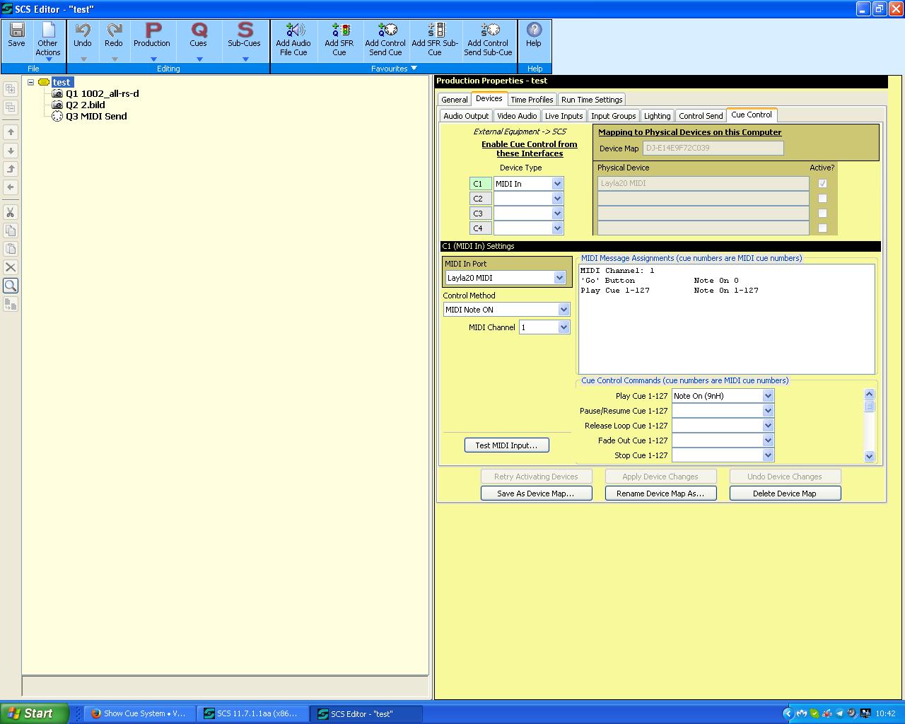

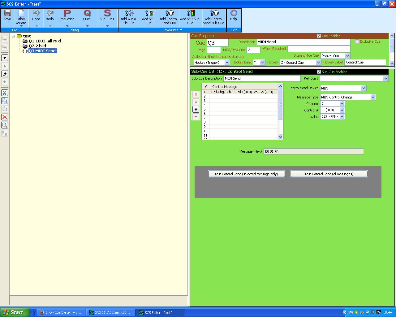

Do You mean something like this:
In this example, Q3 is triggered by MIDI NoteOn 3.
HTH Jörg
