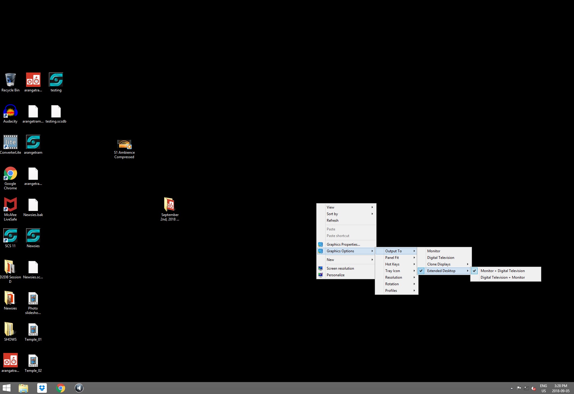

Re: second screen
I have solved this on my system.
I had to use the "Intel Graphics control" rather than the system display settings.
If you have the same graphics chip / software:
Right click on the desktop
in the context menu will be "Graphic options" with a further pull-down menu
in there should be "Output To" with a further pull-down menu
Here you can choose the order your displays are initiated in, allowing you to choose which screen is your video output for SCS.
- desltop menu.jpg (149.22 KiB) Viewed 368 times
