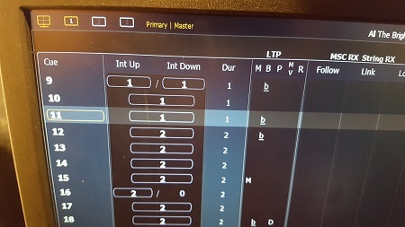

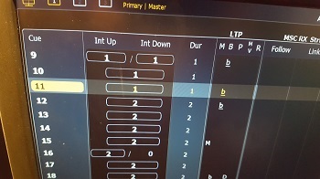

I had trouble but finally succeeded in getting SCS "command" to fire cues on my Element. BUT. The cues trigger, yet nothing happens. The fired cue has a gold outline, but the lights themselves do not change. When pushing a go button on the board, the present cue is in a solid gold box. Not an outline. it's as if I just punched "cue 11 enter" on the console. looks like it needs one more command to actually make it "go".
I am using " /eos/cue/x/fire" as the command (worked on Q-Lab).
I have tried substituting "start" and "go" as well, but they all come to the same nothing. What am i missing? I tried MIDI show control as well, but Element just would not listen, no matter WHAT settings I used on either component. Never had this trouble before. What protocol should I be selecting from the list of types ("other")?
This is going to be used for a lighting sequence triggered by timed triggers in time with music.
Using "go" button
With OSC command
20170820_203553 small.jpg (46.77 KiB) Viewed 600 times

Okay- I finally got it to work! In frustration I added another"/fire" after the first one and BINGO. So it is now
/eos/cue/x/fire/fire
don't ax me why. thanks all.

I've emailed you details of a tracing version to run so I can check if SCS is actually sending the full message.
Re: OSC control to ETC Eos board
Post by Mike Daniell » Mon Aug 28, 2017 2:09 pm
"smacks999' has since advised: "Turns out I was sending Ascii instead of real OSC. Using a different setup for network, and using "free format", it now works as it should".
