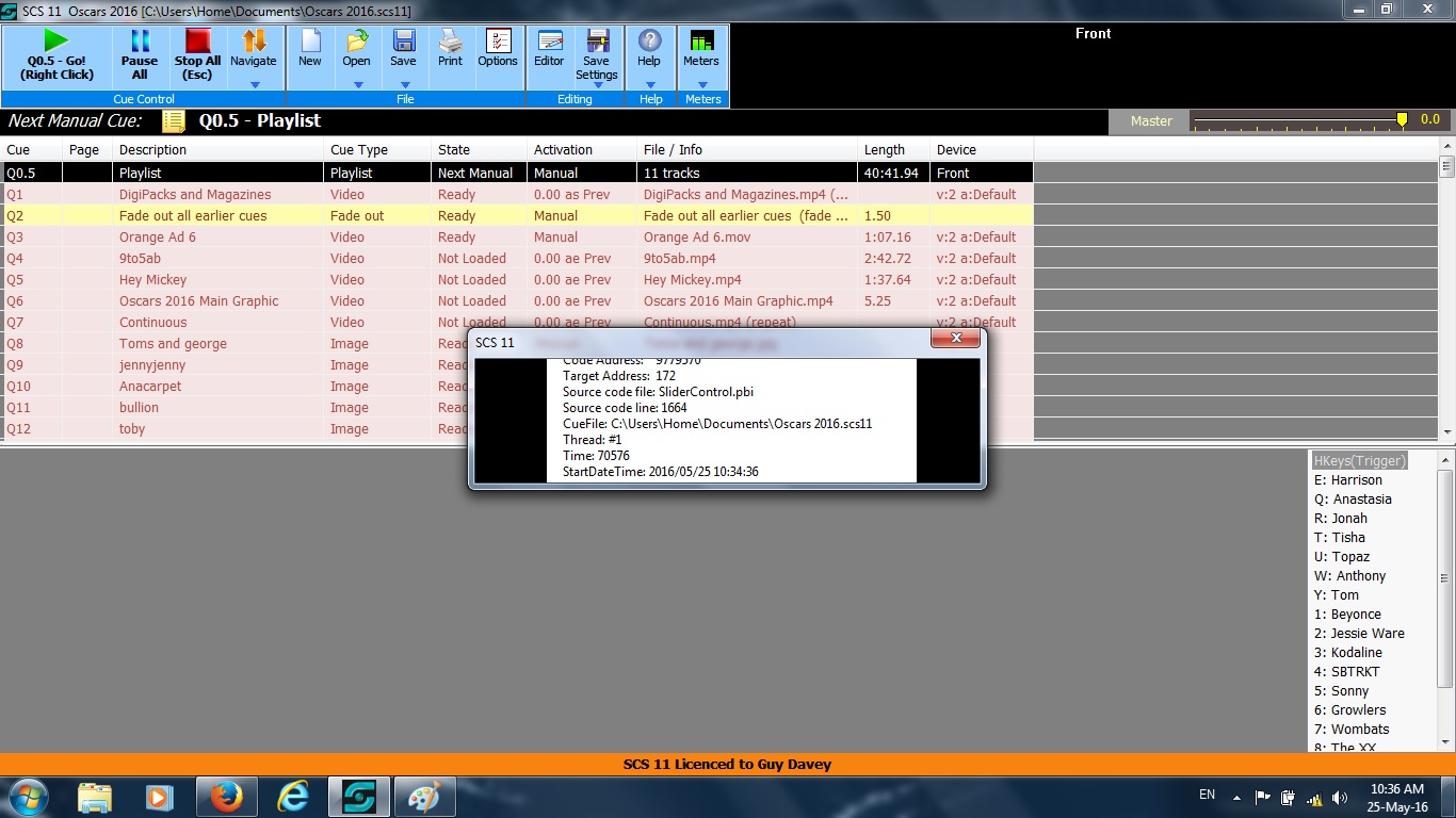

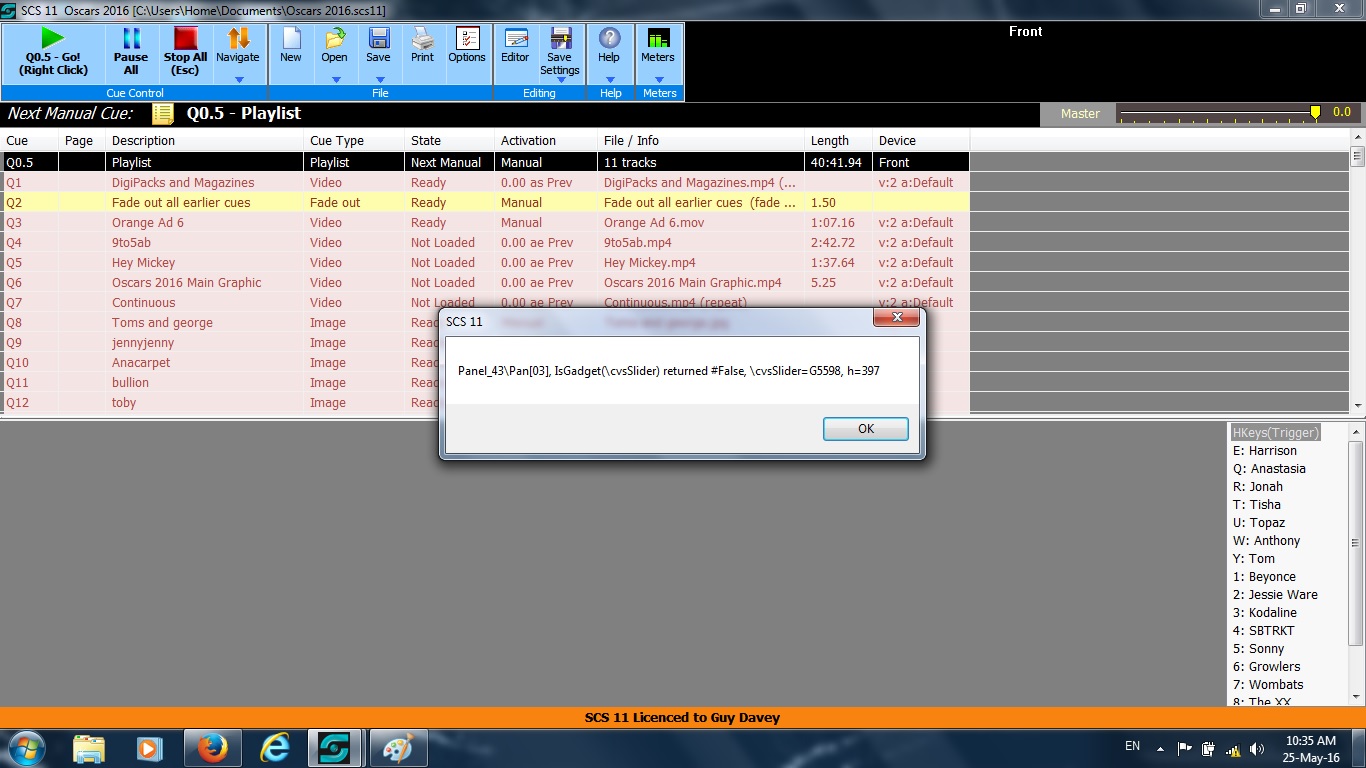

Further to my last post I am sitll having difficulties. The gapless playback issue seems to have been solved on this show file, but there are lots of other issues:
1. When I try and run the show with the TVG video driver I get two error messages. Picture attached. The cue panel section of the Main Window doesn't load. I have the latest download of the ffdshow video codecs. I have also tried uninstalling ffdshow and running without.
