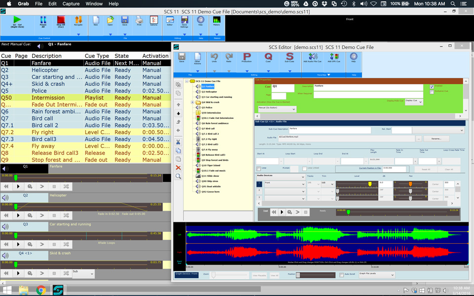

I recently went all-Mac for my sound design and music work, but I am still devoted to SCS. Even QLab doesn't come close, IMO. But rather than go the BootCamp route, I decided to try using VMWare Fusion 8. Other than Windows 8.1, a few utilities, and DropBox, there is nothing else installed except SCS. It took a little getting used to, but everything seems to run fine. My only problem is that the non-scalable fonts (in the control bar and the editor) are just too small [see screenshot] to be readable unless I set the display at the Larger Text setting. Is there a way to make these fonts larger without having to reset the display every time I want to work on a project? Would this still occur if I did it through Boot Camp?

Does it help if you change the Font size under Options / General? I can't currently test this on a high resolution monitor as my secondary monitor resolution is 1920x1200 and the default SCS font and font size (Tahoma, 8) display clearly. In Windows I have the "size of text, apps, and other items' set to 100%.

After all that, I solved the problem. In VMWare Fusion, there's an option under Settings > Display to turn off the full resolution of the Retina display while using Fusion. That brought everything back to the proportions I was used to.
