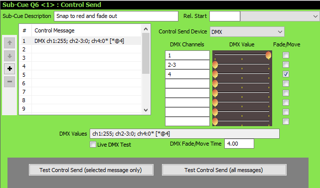

SCS Cue Control via DMX has been available to SCS Professional Plus users for some time, and as from SCS 11.5 Control Send Cues will be able to send DMX to control lights or anything else that uses DMX. You will need a Professional Plus or higher license to use this feature.
Here's how a DMX Control Send cue could be set up:
