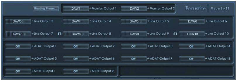

The audio channels that flow from computer to Scarlett are called DAWxx into the Scarlett mixer. You must connect DAW inputs to Physical outputs.
The routing section of the Scarlett mixer should show something like the attached image (ScarlettRouting.jpg)

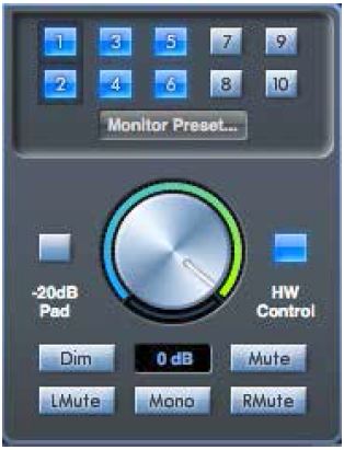

You should set the monitor section (ScarlettMonitor.jpg) to full passthrough. Shift+Clic on all the buttons with numbers 1 to 10 to set it grey (no blue nor red).

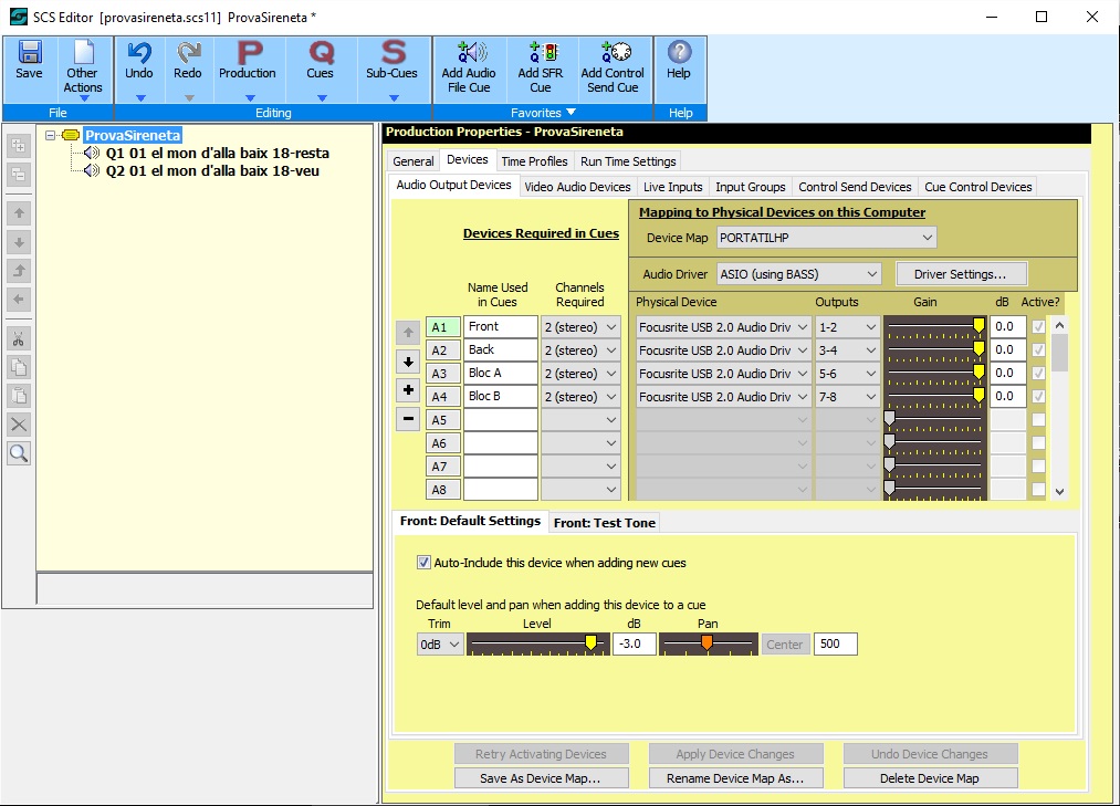

In SCS/Devices/Audio Output Devices, you must select ASIO (using BASS) as Audio Driver and add audio channels (A1, A2...) where the physical device is "Scarlett 18i20"

- ScarlettMonitor.JPG (30 KiB) Viewed 458 times
- ScarlettRouting.jpg (49.68 KiB) Viewed 458 times

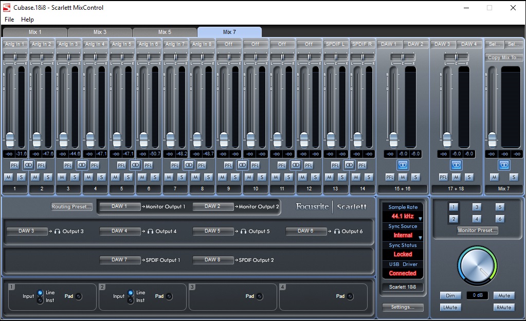

Attached you can see a setup of SCS and Scarlett 18i8 for direct output.
- SCS.jpg (207.83 KiB) Viewed 445 times
- Scarlett.jpg (238.15 KiB) Viewed 445 times
