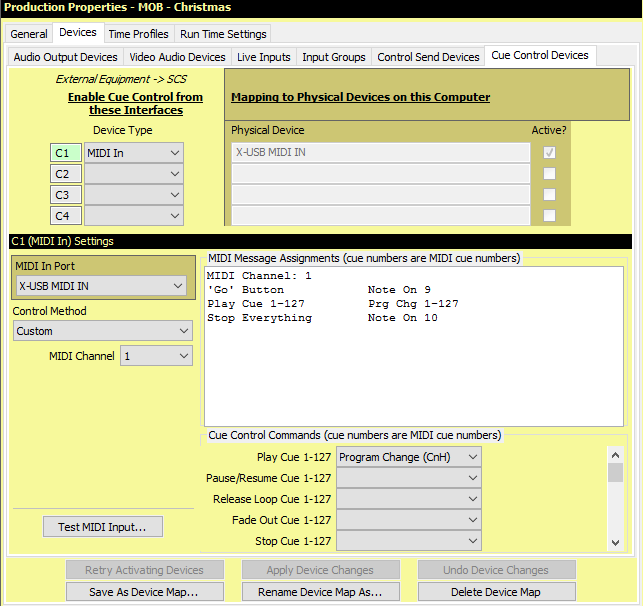

For example, in a recent production I set up a Cue Control device like this (scroll down the image if necessary): On the X32 I used buttons 9 and 10 in Set C for 'Go' and 'Stop Everything' respectively, with button 9 set to send MIDI Note On 9 and button 10 set to send MIDI Note On 10.
But what really applies to your request is button 11. In my SCS cue list I have a hot key cue to 'fade out all playing cues'. This hot key cue is assigned to Key F but I've also assigned it a MIDI Cue Number of 99. On the X32 I have set up button 11 as MIDI Push, Pgm Chg (Program Change), Channel 01, Value 99.
Now when I press button 11 in set C on the X32, this activates my SCS hot key cue to fade out all playing cues.

There is one more setting you may need to change on the X32. Under Setup / Remote, set MIDI Control Interface to 'Card MIDI'. This is because MIDI will be sent via the 'USB Audio Interface' connection, which is the 32-channel card (not via the 'Remote Control USB port). I don't have any of the MIDI Receive or MIDI Transmit checkboxes selected.

See Cue Properties in the Help. The MIDI/DMX Cue Number should be visible if you have set up the MIDI Cue Control device under Production Properties.
