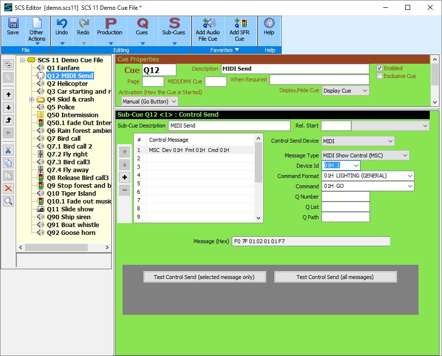

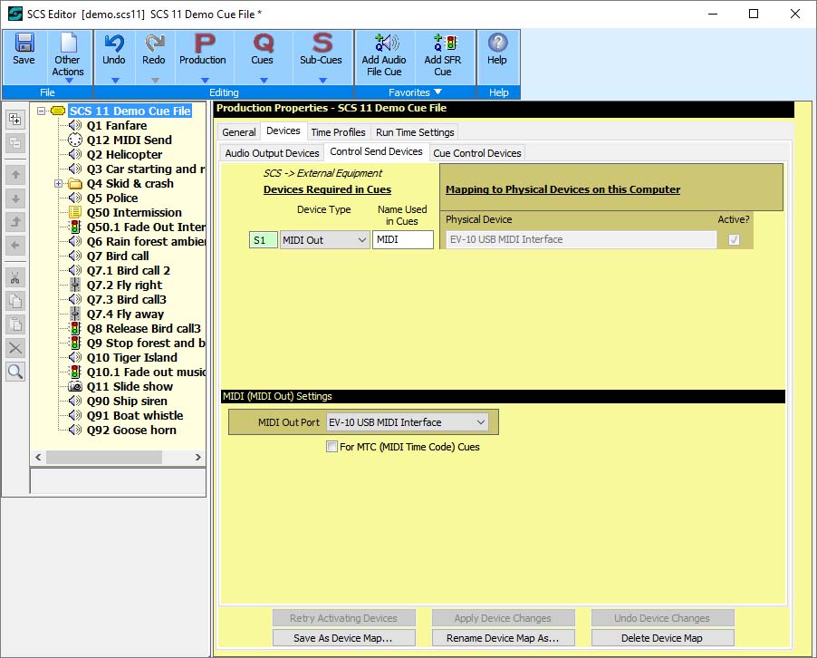

Have attached 2 screen shots of the production properties and the cue.
With the control cue I have tried it with and without a lighting Q number
Can anyone possibly point me in the right direction.

I've run some tests here and MSC is being sent OK. Could you email me a diagnostic file? You can create this file by selecting 'Create Diagnostic File' from the drop-down menu displayed when you click the Help button in the main window. The file will be saved in a folder named "SCS Diagnostics" under "Documents" or "My Documents".

Thanks for the diagnostic file. I can't see anything wrong in your cues or in SCS, provided you have the MSC Device Id set correctly. I've extracted your cue file from the diagnostic file and run the MSC cue (Q12) sending the output via a 'loopMIDI' port to MIDI-OX. The input window of MIDI-OX showed:
Code: Select all
TIMESTAMP IN PORT STATUS DATA1 DATA2 CHAN NOTE EVENT
 00018E51   3  --     F0  Buffer:     7 Bytes   System Exclusive
 SYSX: F0 7F 01 02 01 01 F7
which is exactly correct for the MSC command supplied in the cue.

Forum user saitekx830 has advised me:
I have done some more investigations and have found that the problem was caused by my USB to Midi adaptor.
The cheap USB to Midi adaptors that I was using are not able to handle the longer data strings of the System Exclusive commands that MSC uses.
I got hold of a more expensive adaptor and everything worked straight away.
