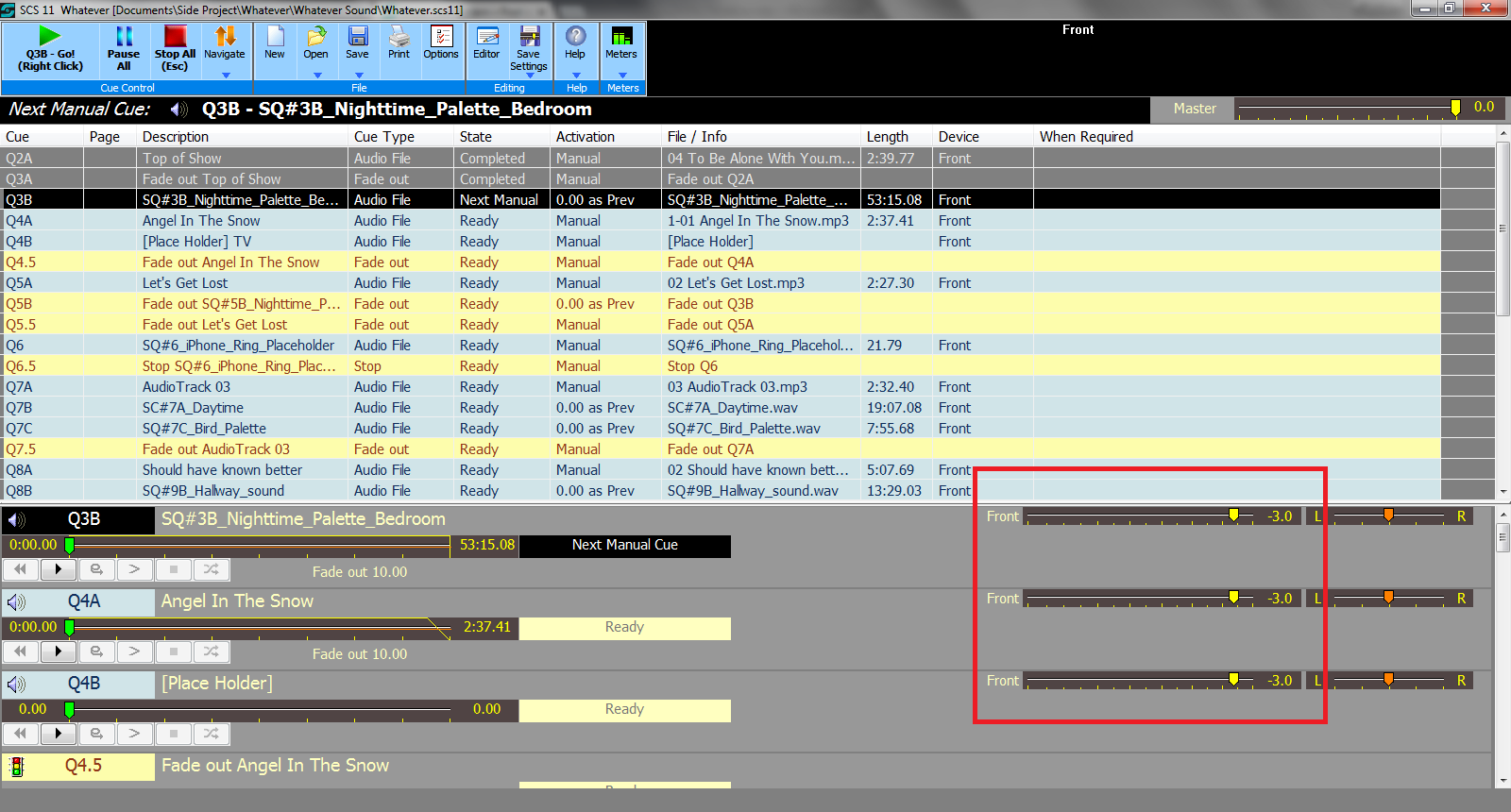

Is it possible, I feel like this worked in a previous version, that when in Design Mode when I change the volume while the cue is playing it doesn't revert back to its original setting? As it stands, as soon as the cue completes, or I stop it, it will go back to the original level. It might be a setting I've missed, please excuse my ignorance.
Thanks so much!
Currently I'm running on 11.8.8 with Windows 7 Pro.
Volume Fader in Design Mode

Re: Volume Fader in Design Mode
Does 'Save Settings' in the toolbar provide what you want?
Yes, that's it! Is it possible to have it default to save changes made while in Design Mode?
Yes, I could add an Editing Option to provide this.
