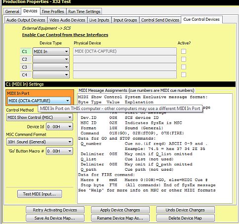

A concern that has been raised with me occasionally is that when you transfer a production to a different computer (eg from home computer to theatre computer) you may need to re-enter certain 'device map' fields, such as cue control parameters. To address this issue I am moving many of the 'device map' fields into the cue file, the intention being to keep only machine-specific data in a 'device map' for that production on each computer.
Here's a sample screenshot of the new Cue Control Devices tab in Production properties:
Cue Control Devices
Previously this tab also displayed the selected Device Map, but that field has been removed from this tab (and also some other tabs) because with this proposed change the Cue Control Devices are set once only for the production and machine, so are independent of any device map selection - although more of that later.
You will also notice that the MIDI In Port has a different background color to the rest of the screen. This background color is common throughout these changes to Production Properties Devices and identifies the only properties that are held on each machine. All other properties are now held in the cue file so are common to all machines on which this production will be run. (I will also wrap that color around the Physical Device and Active fields in the upper part of this tab.)
When you set up your production on your 'design computer' you should set up all your device properties, including the Cue Control device properties. As these will now be saved in the cue file then when you copy this cue file to another computer, the only Cue Control device property you may need to set or change on the target computer will be the MIDI In Port (or similar property for other device types).
Similar changes are being made to the Control Send Devices tab.

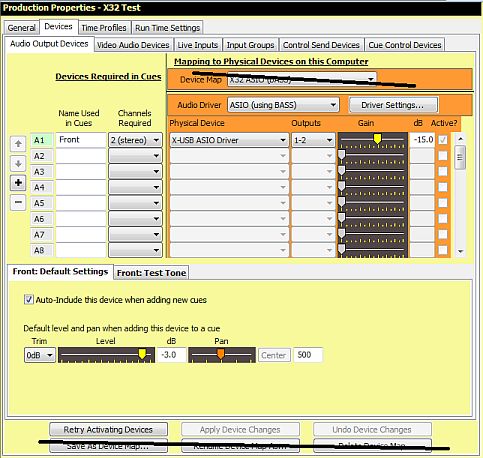

The Audio Output Devices tab is also similar but I am proposing to remove all references to 'Device Maps' as shown here:
Audio Devices
As you can see, this is a 'work in progress'. I plan to remove the 'Device Map' field and the associated save/rename/delete buttons. As per the color convention of the other tabs, the new background color around Audio Driver, Physical Device, etc indicate that these fields will be saved on the current machine (for this production). However, although there will no longer be separate Device Maps, SCS will effectively save a 'device map' per selected Audio Driver. So you set up your preferred physical devices and outputs, etc for DirectSound and have a separate selection of physical devices, outputs, etc for ASIO (using BASS) and ASIO (using SM-S). So you can switch Audio Driver as required and SCS will remember the relevant physical devices, outputs, etc for each selection.

I use "audio output devices" and "send control devices" only.
I understand that if I set outputs A1 to A8 for a cue in the project, when I open the project in an other computer, SCS assigns the physical outputs defined in the device map. This is a good way (something similar is used in Cubase and it works fine)
But, I use sometimes an internal audio device sometimes an external audio device.
If I change the “Audio driver” physical device assignments will it be recovered?
Device maps will be helpful to switch between physical device configurations, may be.
Example:
In the theatre computer with an external device that has a lot of outputs I wish to send A1 (front) to Out 1-2 and A2 (rear) to Out 3-4.
In my laptop with internal audio device only (two output ports), I wish to be able to send A1 and A2 to the same Out.
But if I connect an external device output to the laptop, as soon I change the audio driver (or the device map) the physical outputs should be assigned accordingly.
Re: Proposed Device Map changes
Post by Mike Daniell » Thu Apr 16, 2015 5:31 pm
Buyaicia wrote:In the theatre computer with an external device that has a lot of outputs I wish to send A1 (front) to Out 1-2 and A2 (rear) to Out 3-4.
The proposed change of removing the 'Device Map' field will handle this situation because on the theatre computer you will specify "send A1 (front) to Out 1-2 and A2 (rear) to Out 3-4" but on your laptop with internal audio device only you will specify "send A1 and A2 to the same Out".
Buyaicia wrote:But if I connect an external device output to the laptop, as soon I change the audio driver (or the device map) the physical outputs should be assigned accordingly.
The proposed change would not handle this situation unless you also changed driver - eg DirectSound when using the internal audio device, but ASIO when using the external device. If you want to use, say, DirectSound for both scenarios (internal or external device) then this is an argument for retaining separate Device Maps for Audio Output Devices. That's probably a good enough reason to retain this particular feature.
