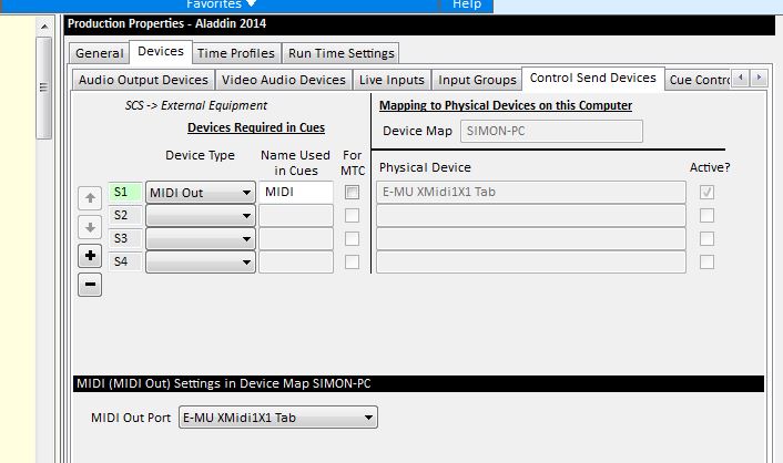

SCS sees the Midi interface, no problem at all - as shown. Screen shot taken just now and interface tested. MIDI control Change and MIDI SHOW CONTROL Messages sent with no errors.
- EMU Midi interface.JPG (55.43 KiB) Viewed 4736 times

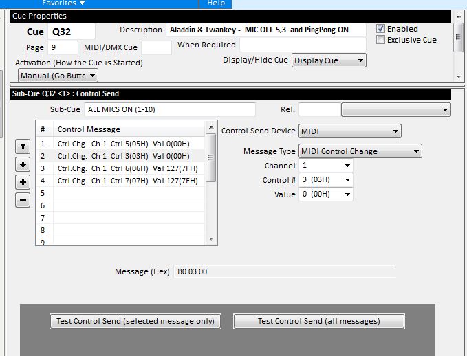

Yeap - in principle you are correct. The software my relay board uses can accept MIDI Note or MIDI Control Change data. I prefer Midi Control Change, keeping a standard workflow when using either Analogue or digital desk. This image is taken from a the Panto I'm doing this December. There will be 19 radio mics plus 7 float mics plus 3 backstage mics (for off stage voice overs). So for Cue 32, Mics 3,5 go OFF and Mic 6,7 go ON at the same time.
For any processing I need (Comps, Reverb, etc), I set these effects up in the Desk (Yamaha M7CL) and assign them to channels 34,35,36. So when I need reverb of a solo song, I use SCS to UNmute channel 34 at the same time as the music track starts and then Mute it again as soon as the the track finshes. This works really well, especially if I have a bunch of other mics that need to muted/unmuted at the same time.
In the past, I have also taken the Midi signal to the ORB lighting desk (MIDI thru from M7CL) and using MSC commands I have been able to trigger the GO button on the ORB together with muting mics, playing SFX, music and Video projections (Our Pantos can be very complex at times). It came really handy when the lighting guy couldn't make one of the performances due to snow storms.
- mic on off.JPG (65.71 KiB) Viewed 4715 times

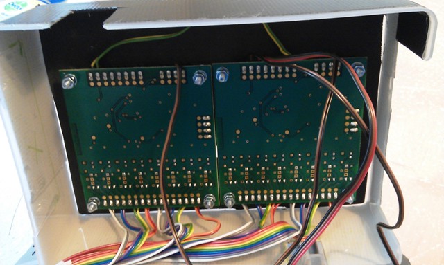

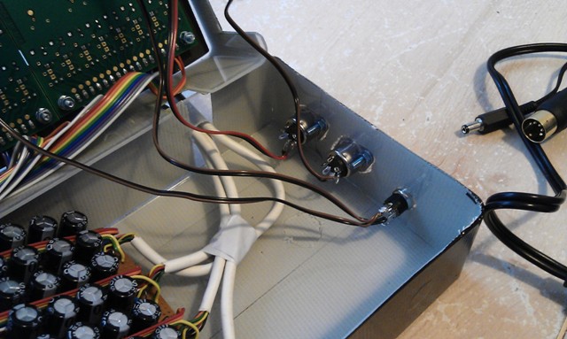

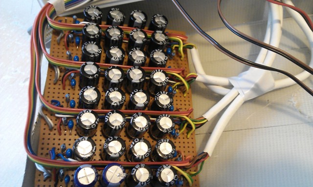

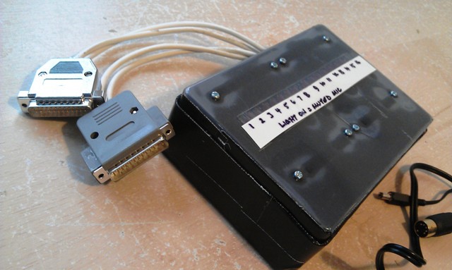

Here are some photos of the finished box and internals (Mic Mute circuits and Midi relay boards)
- IMAG0413.jpg (81.28 KiB) Viewed 4710 times
- IMAG0412.jpg (52.97 KiB) Viewed 4710 times
- IMAG0417.jpg (58.55 KiB) Viewed 4710 times
Re: midi control sends via usb

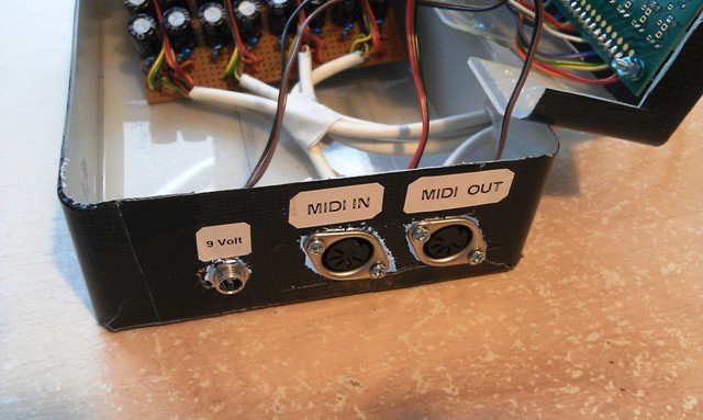

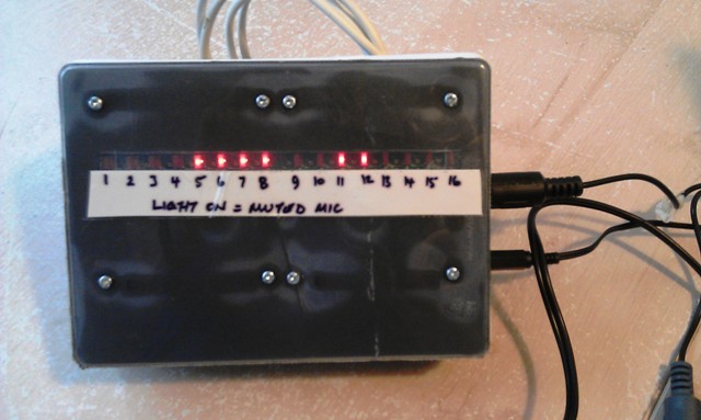

and final 3 photos
- IMAG0416.jpg (72.73 KiB) Viewed 4710 times
- IMAG0415.jpg (64.64 KiB) Viewed 4710 times
- IMAG0414.jpg (68.38 KiB) Viewed 4710 times
