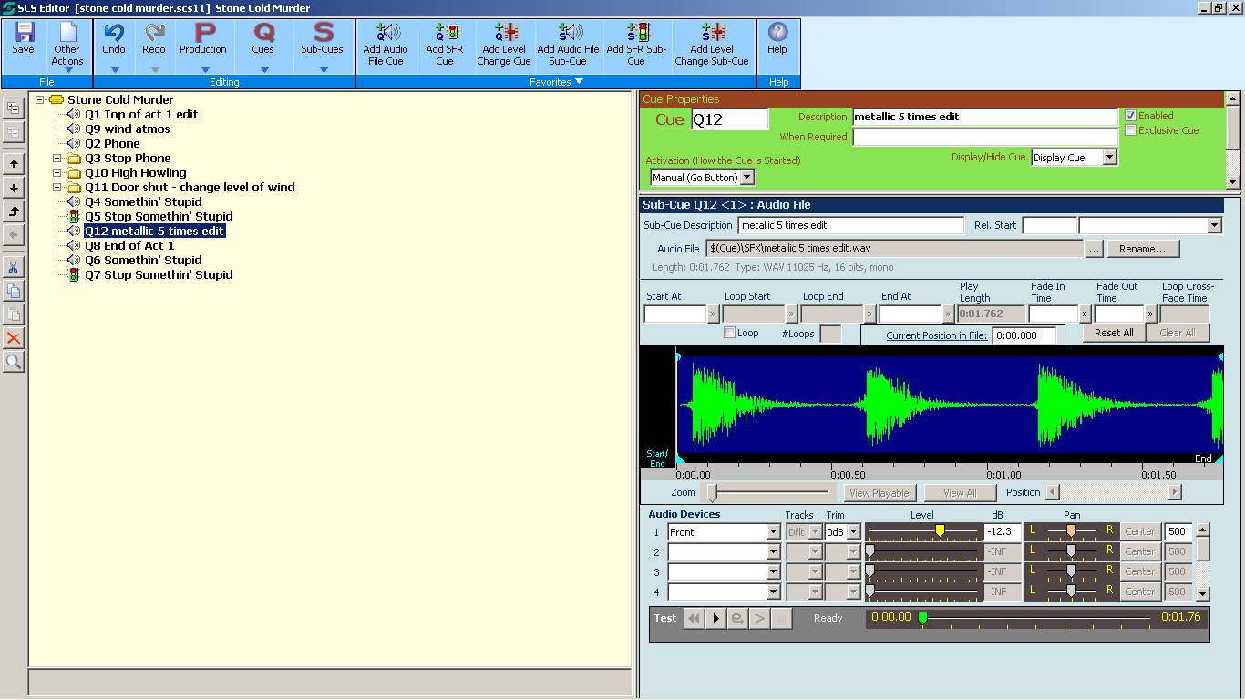

I'm currently using SCS version 11.2.5 to prepare the sound for our next production.
My tracks are not displaying properly in the audio graph in the editor, which is making it hard to accurately select start and stop times. The best example I have of this is a door knocker Sound Effect that has five knocks in the track. I sometimes want there to be a different number of knocks when using this track, and would usually just adjust the stop time to give me, say, 3 knocks. However, the audio graph is only showing three and a bit knocks instead of 5, although there are definitely 5 knocks in the track. I have attached a screen shot to show this.
Is there anything I can do to make the audio graph more accurate?
Thanks
scs screenshot.jpg (141.26 KiB) Viewed 343 times

Try adjusting your cue list window width.
Also, have you attempted to zoom in and then out on the graph? That might reset the view.

Post by Mike Daniell » Sat May 24, 2014 8:03 am
Try the latest SCS 11.3.0 release candidate. The changes include: "The Audio Graph is now displayed the full width of the Editor window, and will adjust as necessary if the Editor window is resized horizontally." Also, you can zoom in further on the audio graph in 11.3.0 than in earlier versions.
