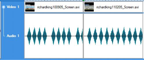

Thanks for the files you emailed me. As mentioned in my email reply, this does appear to be an issue in SCS 10.9.5 but there is no delay at all when running the cues with the latest version of SCS 11. I recorded tests with Camtasia and the audio track below clearly shows the difference between SCS 10.9.5 and SCS 11.2.5:
The AVI file on the left is as played by SCS 10.9.5, and the AVI file on the right is as played by SCS 11.2.5. (Although 11.2.5 has not yet been released, I get the same results using 11.2.4.) With 10.9.5 there is a significant delay at the end of the loop of playing the 4th instance of the cue. With SCS 11.2.5 there is actually a slightly shorter delay at the end of the loop, and that's because your 2nd, 3rd and 4th cues are all set to start 200ms after the end of the previous cue, whereas your 'Go To' cue after the 4th cue is set to start immediately after the end of the previous cue.
In summary, yes, this does seem to be an issue with SCS 10.9.5 but there is no delay when using SCS 11.2.5.
