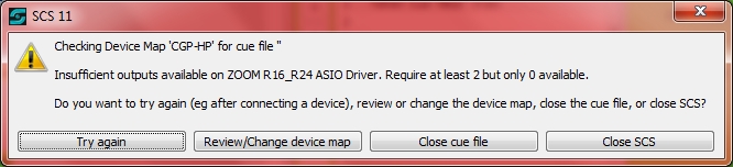

SCS11 has gotten into an intolerable state. When I start on my laptop, any attempt to create or edit a show results in a failure dialog, a picture of which is attached.
The ZOOM is not even connected to the laptop. Naturally, I say "Review/Change device map" to try and straighten out confusion. THEN, I get:
SCS Device Init/ ASIO Channel 0 cannot be enabled. With an OK button (I HATE dialog boxes that only offer "OK"). Press it, same error message for ASIO Channel 1.
Press OK again, "Error/ Cannot get a free channel", etc. Press OK to that, I get "Program Error detected, invalid memory access", blah-blah (fyi, it is in modVUDispla.pbi, line 583. I have 11.1.4).
This seems a ridiculous behavior in the face of some hardware not being present. I'd have expected something like, "ZOM not connected, you want to use default h/w", and then just adjust to the situation. Crashing is not good form. Crashing and never even allowing me to reset things is horrible form.

- Error dialog.
- scsErrDialog.jpg (74.28 KiB) Viewed 386 times

Sorry about the problems. Another user reported a similar issue and after some research it appears that when SCS obtains from the BASS audio library the list of ASIO devices there is no indication as to whether or not each device is actually connected. This was not an issue prior to SCS 11.1.4 because by default SCS selected the default DirectSound device when setting up a new production. But in 11.1.4 this was changed to select an ASIO device, the theory being that by default SCS would use ASIO.
Due to the issue of disconnected ASIO devices, in SCS 11.2.1 I have reverted the default to DirectSound. So could you try SCS 11.2.1 RC2 which I've just uploaded? See SCS 11.2.1 RC2 (Release Candidate 2) Available for details.
