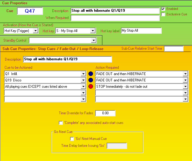

In the cue list there were two such cues that could be hibernated: Q1 and Q19. Here is a solution that requires just one hot key cue. See this screenshot for details on how to set up this cue - which I recommend be added to the END of the cue list: Now if the director calls a pause, then instead of pressing escape you press S to activate this hotkey cue. If Q1 or Q19 is playing at the time, it will be immediately hibernated (note the 'time override for fades' is 0.00), and any other playing cues will be immediately stopped. You can now click on another cue to reposition the cue list as required, and your hibernate cue should remain hibernated, ready for resuming.
The above screenshot is from SCS 10 but a similar solution should work for SCS 11.

I've used this programmed feature at the last two rehearsals and confirm that it does everything that I need. If the Director requests a "backtrack" I just hit the "S" key, the click on the desired earlier cue in the list and replay with all hibernation effective and capable of subsequent reactivation.
