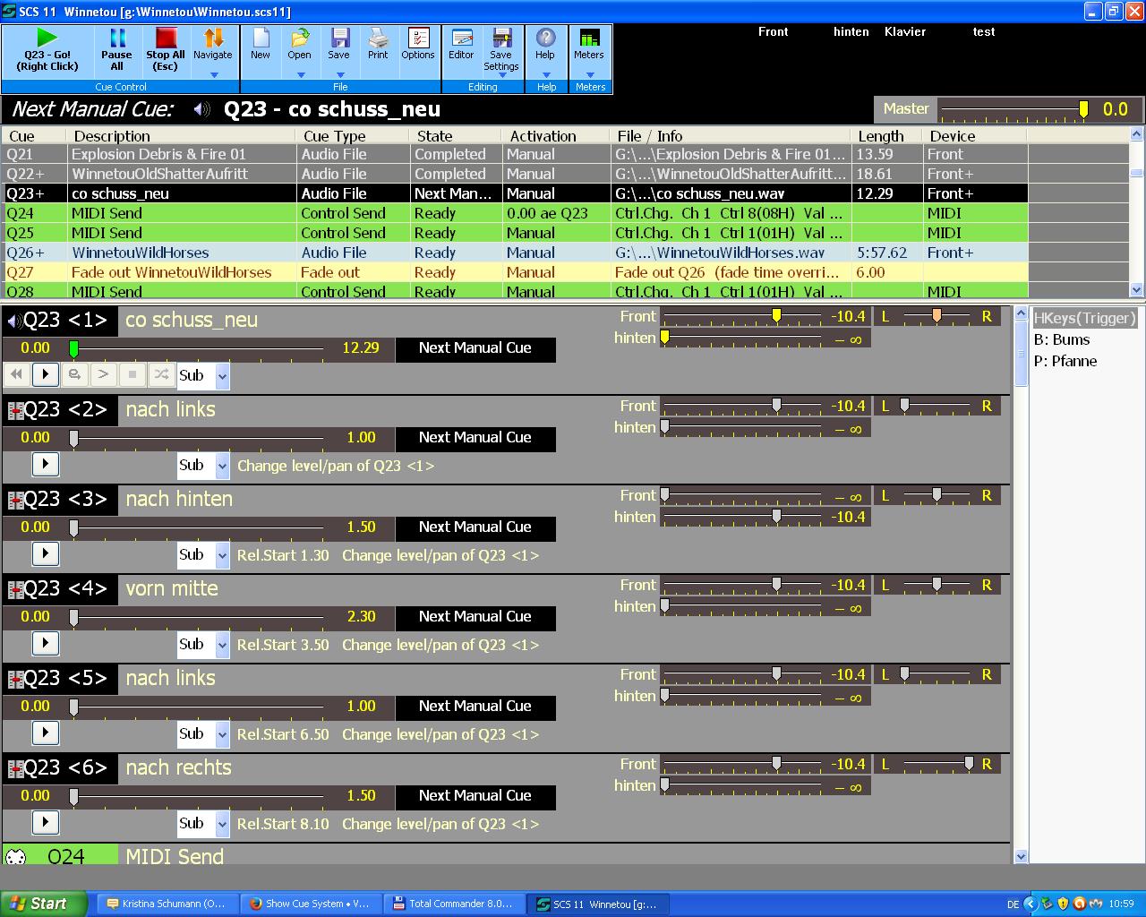

Hi folks,
by chance we had such thing in our "Winnetou" production open air this summer. A gun is fired and the bullet flies to a rock front left, a building behind the audience, a rock on middle of the stage, font left again, then to the right of the stage and hits a tree. It's Q23, an audio cue with some sub cues for the panning: Regards Jörg
