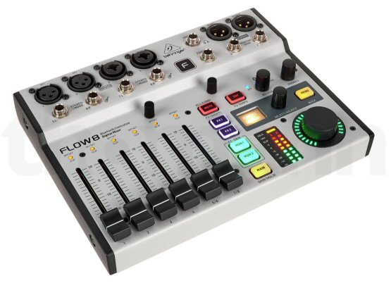

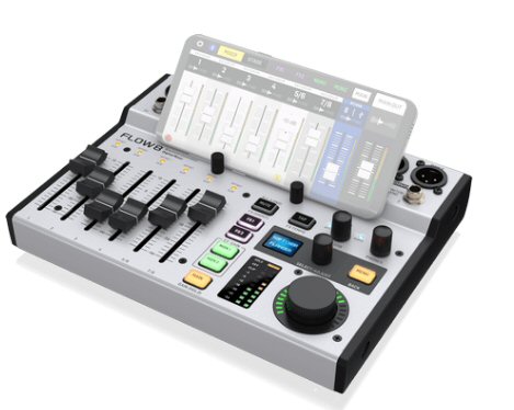

Re: supported audio devices: Behringer FLOW8
And now it's the year 2023
Behringer gave birth to a new child in November 2022!
The small digital mixer FLOW8 With an unbelievable number of excellent properties and possibilities.
And it's not the end yet, the community's wishes are being converted into new firmware and it already supports it perfectly.
I don't work for Behringer, I'm not making a profit and I paid full price for FLOW8
Read complete information and description directly from Behringer...
Here for the forum only important pieces of information for the questions from earlier.
Yes, up to 8 input channels are read into the DAW via USB.
Channel 5/6 and 7/8 are stereo channels. These can be configured as input from USB.
So 8 line channels with connection to the mixer XLR/Jack can used in your DAW
Or as I do it: 4 line channels directly on the mixer (microphone) and 2 stereo channels come from laptop/SQS/USB with playback.
Back to SQS:
After installing the driver from Behringer, the device "FLOW ASIO Driver" is immediately visible in SQS with all 4 outputs.
I chose them and gave them names:
Main / L
Main / R
monitor 1
monitor 2
Audio cues can be sent individually to these 4 (SQS) outputs and will then be seen in the mixer app as a two USB stereo input.
If you have it configured in the APP.
And assigned as you wish, with EQ and effects too.
For sending audio cues I use
source USB1 (5/6) and send individual Volume to Main L or R
Source USB2 (7/8) and send individual Volume to Monitor 1/2
The routing is easy to understand.
The FLOW8 is super cheap if you understand what it can do, it currently costs €272.39
Using it as a standalone mixer is also great, or in combination with the app.
It has no motorized faders, which is not possible at the low price.
For the faders that have been adjusted in the app, there is a display and the option to very easily move the fader to the required position for further manual movement.
It's still a very young device (November 2022) and I'm sure it still has a lot of potential.
Erwin
