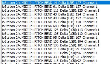

I have a midi controller (ioStation24c of Presonus) that has a touch fader that sends two pitch bend bytes changing the LSB byte too.
From Pitch bend 0 LSB 0 to Pitch bend 127 LSB 127 (see attached image)
LSB can only set to a permanent value in control send
How can I set it to control SCS Fader?

I've just downloaded the manual and it mentions both LSB and MSB ('Low 7 bits' and 'High 7 bits'). So what's sent in the MSB? Can you log that as well?

I'll run some tests with my BCR2000. Seems I can program that to send Pitch Bend messages.
