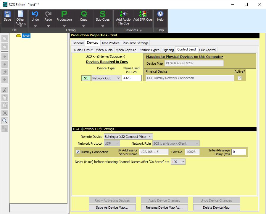

Another query.
Testing the demo software, I only seem to be able to set up one (1) Control Send Device and one (1) Control Cue device. Trying to setup network command cues to fire off Snippets on an X32 as well as Midi commands to some lighting software on another PC. Each works in isolation, but I can't seem to see how to set up more than one device as would appear to be possible in the documentation (refer to sections on Control Send Devices). Is this a limitation of the demo software.
Brendan
Brendan
- SCS Test Control Send.JPG (98.86 KiB) Viewed 1345 times
Re: New User Questions
Yes, that is a limitation of the demo. It enables you to test Control Send functionality but does not support multiple devices.
The number of Control Send devices supported for each license level are:
- Demo: 1
- Lite and Standard: None (these license levels do not support Control Send cues)
- Professional: 4
- Professional Plus: 8
- Platinum: 16
