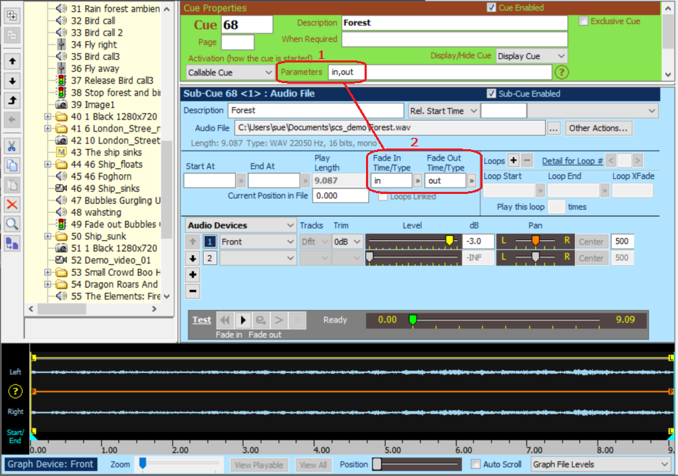

Audio example:  To add a callable audio cue add your audio cue as normal, then from the drop down box Activation choose Callable Cue. This is the cue that can be called by cues of type Call Cue, the "Call" cue can have the ability to override some parameters such as fade in and fade out times.
Add your parameters to the Parameters text box at the top of the window as shown below, remember to separate your parameters with a comma. The defaults can be set by adding an equals sign after the parameter name followed by a number. e.g. in=1,out=2. (See also more information about parameters further down this topic.)
In the respective parameter boxes, in this case Fade In Time/Type and Fade Out Time/Type you need to put the parameter names NOT the time values, so the Fade In box should contain "in" and the Fade Out box should contain "out" for this example. Save this cue, normally these callable cues should be added at the bottom of your cue list after the last actionable cue like hotkey cues.

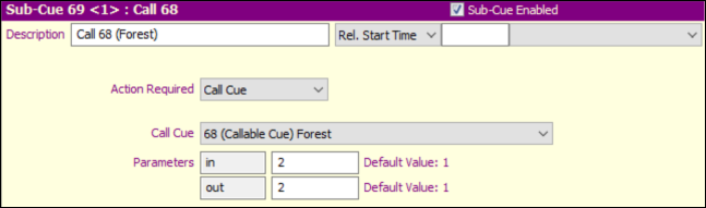

Higher up the cue list at the place this needs to be first called add a Call Cue cue. Set the Action Required to Call Cue then select in the Call Cue dropdown box the cue you want to call and have previously set up. The parameters you entered will be displayed and you can fill these in as need be. Save this cue and then add copies wherever you need to use this cue remembering to adjust the parameters as needed.
