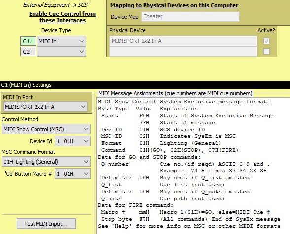

My show file is at the theater, with the light board that sends the messages, so I'll need to get the diagnostic file from there. But in the meantime, I have a screen shot of my MIDI message setup. That may have pertinent information that will help triage before I get the diagnostic to you.
MIDI Setup
Midi Setup.jpg (119.3 KiB) Viewed 1880 times
