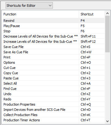

there are already shortcuts for rewind, play/pause, stop (F4, F5 and F6) inside the Editor..
Space Bar I think is difficult as you wrote..... (text input/selected).

You can change the default shortcut key to Space bar. I tried it and it works. However there is a gotcha if you need to use a space in entering text anywhere on the Edit screen.
