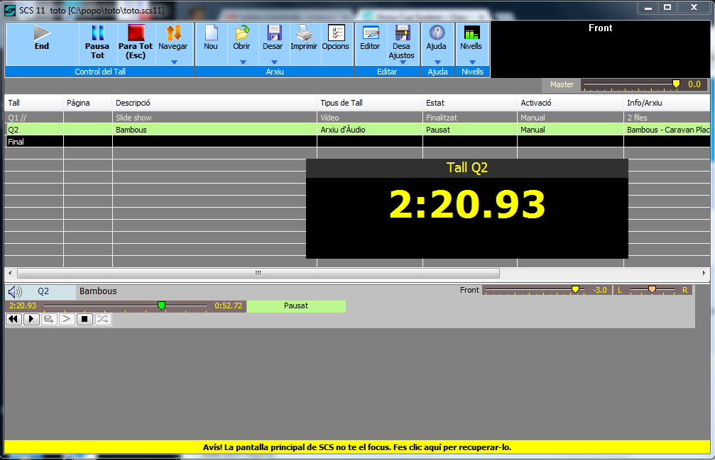

Re: Large Midi Timecode Display Window
Post by Buyaicia » Thu May 29, 2014 4:00 pm
Manne wrote: A major problem is to see the little counter / clock because it is so small
Therefore, it is my wish that in a newer version if it is possible to get a frame or a window that is larger for the clock.
Märsta, Sweden
You can set up the visual warning:
Click Editor
Click Production
Click Production Properties
Select Run Time Settings tab
Select"Count UP Whole cue" at "Give Visual Warning"
Select "Time Format" at "Visual Warning Display Format"
May be this is what you want.
Manne
Joined: Wed May 28, 2014 6:16 pm
Post by Manne » Mon Jun 02, 2014 5:26 pm
Hello
Thanks for the tip. Just what I was looking for.
