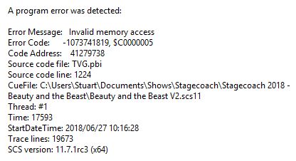

I tried increasing the pre-open count to 30 but got the attached error - presumably because my PC had run out of memory. This also happened when I reverted to 11.7.0
Fortunately the producers have provided a backup option for this show using Powerpoint so I will be OK this weekend but it is a shame not to be able to use SCS.
