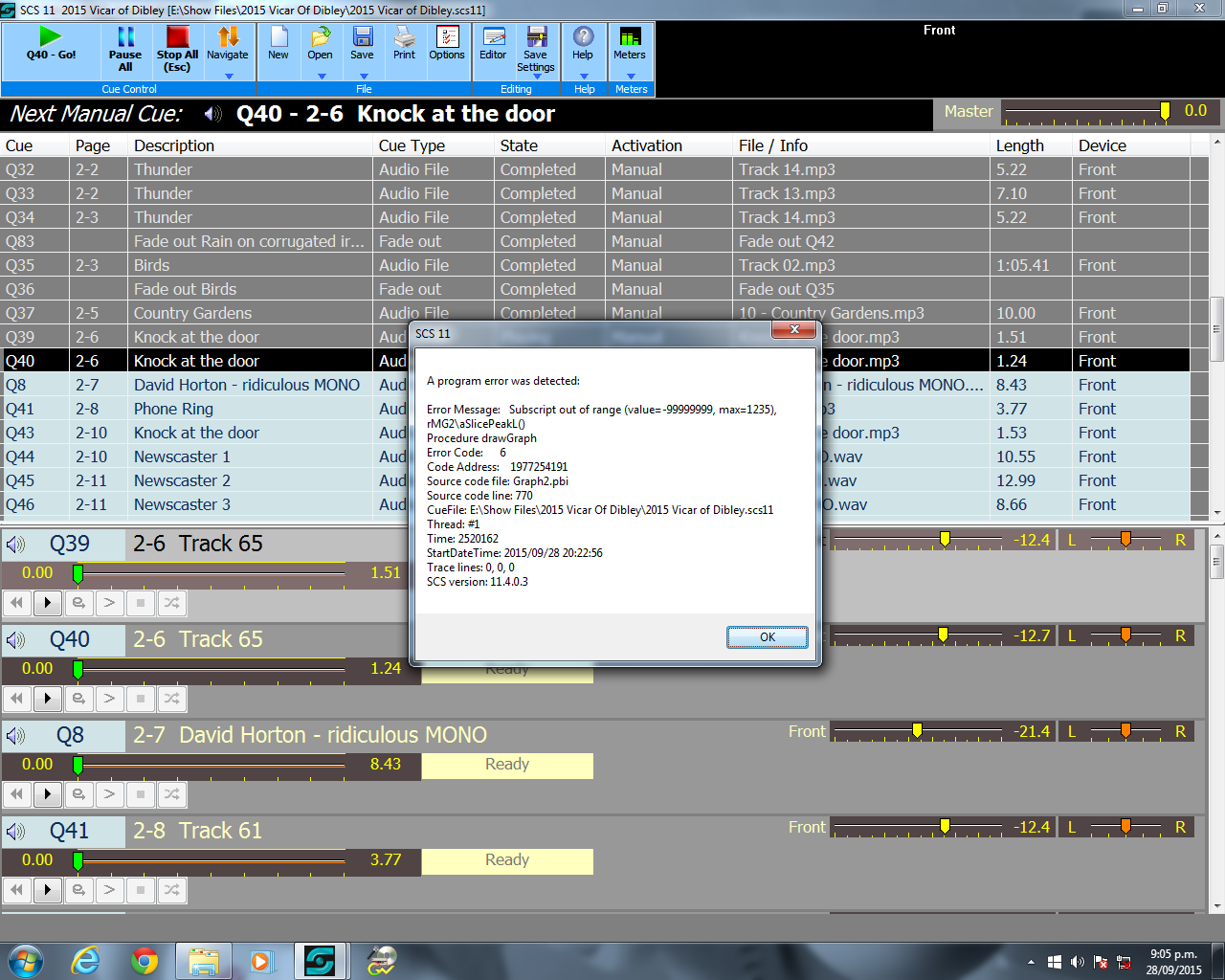

Post by thewiz » Mon Sep 28, 2015 6:19 pm
Finally caught it. Image attached.

Re: Invalid Memory Access Error
Post by Mike Daniell » Wed Sep 30, 2015 2:17 pm
I've now been able to reproduce this error and have a fix ready, which hopefully will be available sometime this week.
Re: [Fix 11.4.1] Invalid Memory Access Error
Post by Mike Daniell » Wed Oct 21, 2015 2:11 pm
Fixed in 11.4.1.
