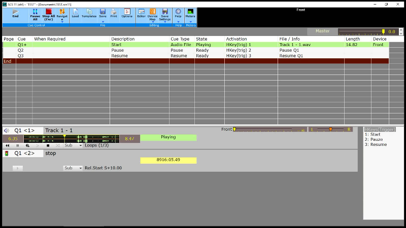

A weird problem in my SCS file. (SCS 11.6.2 (x64)
When I pause a group cue (first sub cue is an audio cue). Al the related count down pause too, which is the part that makes sence.
But when I resume that group cue, arround 8900 seconds get added on the count down number.
Group cue's without an audio file can not be paused. I think that's strange, when there is a delay for exaple, it would be a nice option to be able to pauze count downs between sub-cue's.
Maybe there can be an option when pausing a cue, if you want it to have affect on count downs and auto follows as wel.
I hope you can help me solve this error.
Lars
Example of the bug.
Schermopname (1).png (142.66 KiB) Viewed 507 times

Post by Mike Daniell » Mon Jul 24, 2017 5:46 am
Thanks for the detailed info. Bug confirmed.
