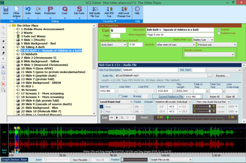

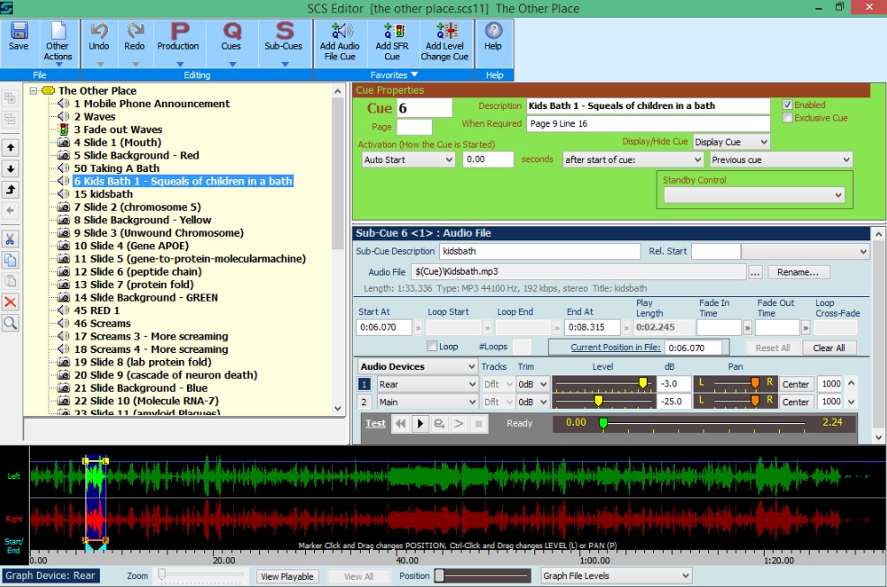

When first in editor mode the ability to adjust devices and level sliders are available.
Dump emailed.
After moving "Start At" and "End At" sliders and playing the test audio, all the audio cues loose the ability to be updated.

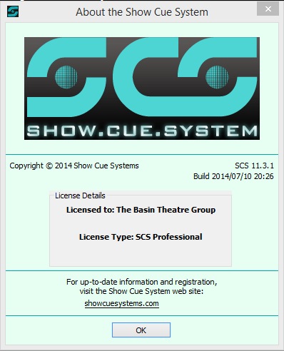

I had this problem in SCS 11.3.0, updated to SCS 3.11.1 - no difference. Cannot find any references in help / documentation.[Fix 11.3.2]Cannot edit audio cue after test playback 11.3.0

I've had this problem too.
If you look just above the list of audio devices (Rear, Main, etc), there is a drop-down field which now says ‘Level Point: End’. If you open the drop-down list and select ‘Audio Devices’, all will be well, at least until the next time.
There is probably an option somewhere which will prevent this from happening but I haven’t found it yet.

Fix ready for 11.3.2.
This was a design flaw rather than a bug per se. Whenever you clicked on a marker in the audio graph, SCS 11.3.0/1 would 'select' that level point or start/end point, and display the relative levels etc for that selection. For 11.3.2 I've now changed this so that if the current selection is 'Audio Devices' then the selection is only changed if you use Ctrl/Click to change the level or pan setting, not if you just use Click to change the position of the point.
