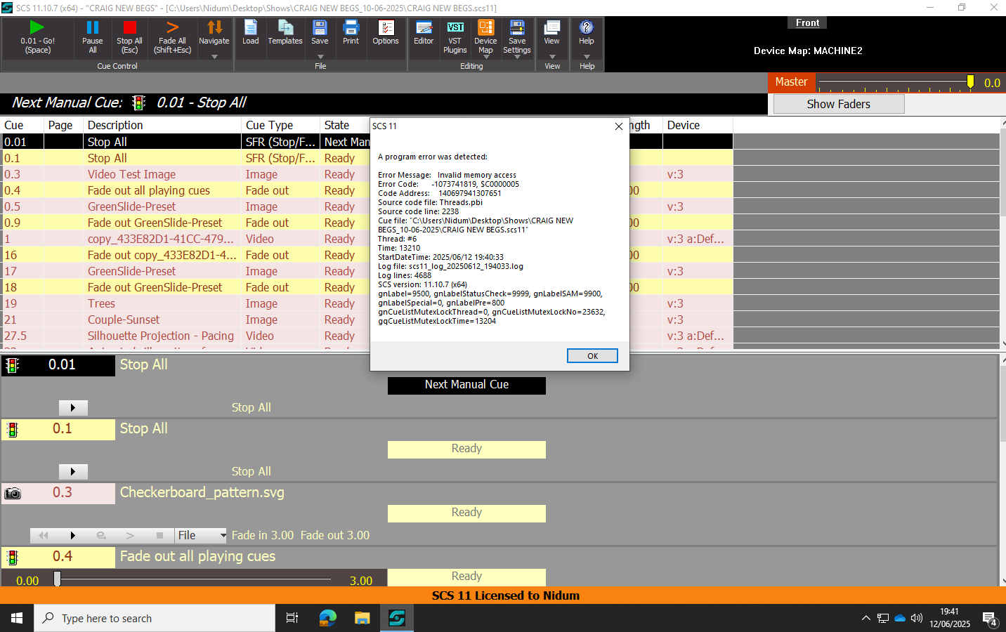

Hi Folks i think i've found a bug. When sending network commands from scs to scs on another computer, if the Cue in cue properties on the receiving computer is all letters, the receiving scs can get a memory issue and close. I've attched photo of error dialog box an log file.

Hi, thanks for the report and the log. We will look into this but it maybe next week.

I've emailed you a new version to try.
