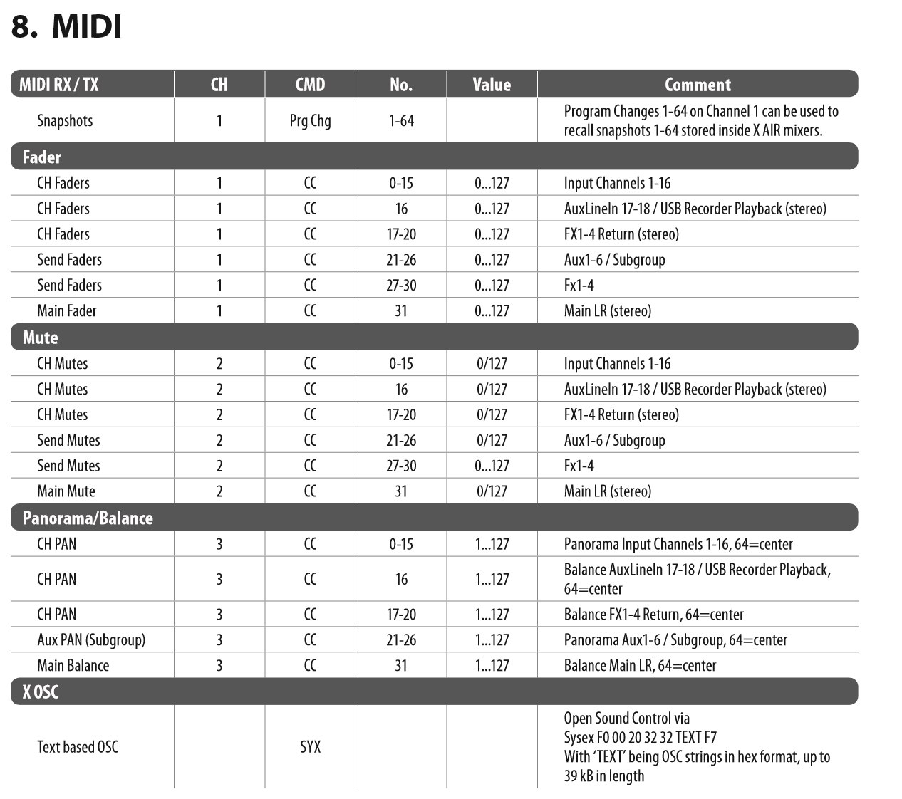

Has anyone had the same success with the Behringer X AIR XR18 mixer? I have managed to get the Midi side of things working as expected, but if the "network out" UDP client could work as well as the X32 or X32 Compact settings, then for smaller shows, this would be great for me.

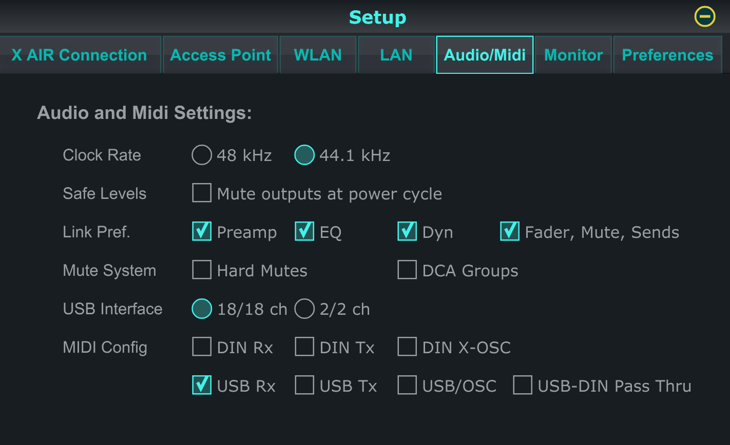

After a bit of experimenting, I can been able to control the mic faders, mic mutes and pans via the single usb cable and selecting "usb rx" in the setting section of the X Air XR 18 mixer.
Midi config info found in Manual. It's different to the X32 but easily understood.
So, one usb cable from laptop to x Air xr18 which sends audio and midi commands to control the mixer. Happy days ...
USB/OSC didn't seem to work at all. Maybe due my lack of my understanding of OSC commands ....
x air xr18 setup.PNG (89.66 KiB) Viewed 4097 times
