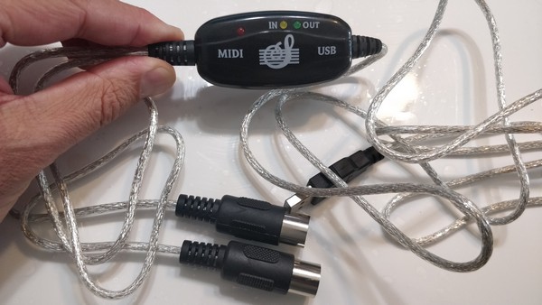

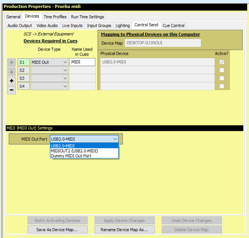

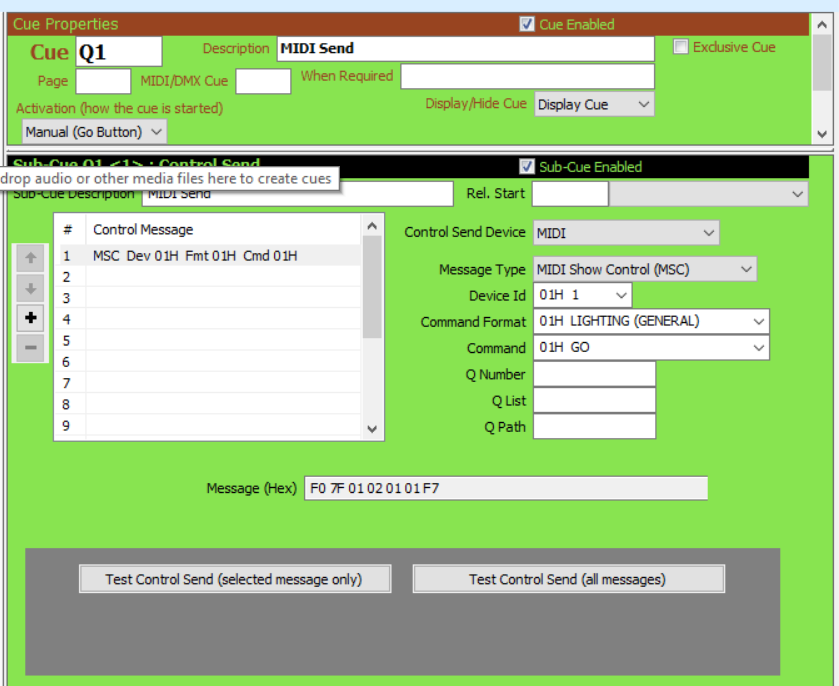

I have a MIDI device and a ETC Console. I would like to send a "GO" form SCS to ETC by MIDI. I don't know why but it doesn't work.

The USB to Midi interface you have is known to have issues with the way it translates the midi commands for MSC. More often than not, the interface doesn't work. I know this from previous experience. I then bought a CME interface which works perfectly and does exactly what you need. It is more expensive than the one you have.
