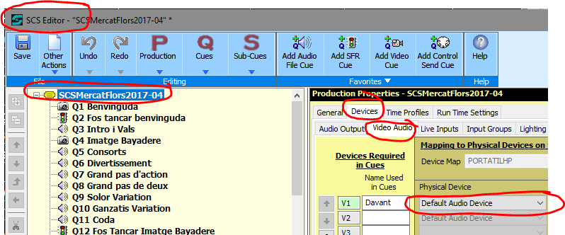

Re: Audio Output selection
Select Editor.
Select the top line in Editing to see production properties
Select devices
Select video audio
And add physical devices
I hope this helps. See the attached image.
Select devices
Select video audio
- Captura.PNG (46.79 KiB) Viewed 10042 times

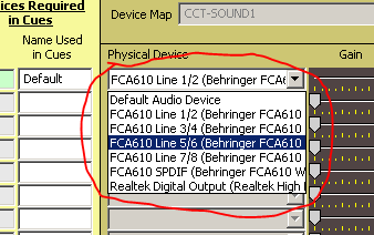

Hi Chad,
From the help file's "Production Properties - Video Audio Devices" topic:
"If you have selected TVideoGrabber (TVG) as the Video Playback library in Video Driver Options then you can select any available DirectSound output device for your video's audio. Although each video cue only lets you choose one audio device, you can use different audio devices for different cues, so in this tab of the Production Properties you can define your Video Audio Devices. If you are not using TVideoGrabber then you cannot choose the audio output device - video audio is always sent to the Windows default sound device."
So the first thing to check, if you haven't already, would be whether you're using the TVG library.
On my system, when I drop-down the Physical Device box it shows me a list of channel pairs available on my Behringer interface, as well as the the default Windows device, so that single drop-down is used to select both the physical device and channel pair, like this:
For me, the awkward thing about this is that I can only select stereo pairs; if I want to send video to a mono FX channel then the adjacent audio channel must be left empty, so it's wasted. Fortunately I have channels to spare.
For you, it's a bigger problem if you don't see a list of choices similar to this. Mike can probably give us more insight, but the list of devices and output channels displayed here is probably limited by the capabilities of TVG and/or DirectSound and/or your sound interface's device driver. If your Scarlet interface has a configuration screen you might want to take a look at it. As the help states, SCS uses DirectSound for video-audio output, so the driver might have options affecting this that are separate from the ASIO configuration options. Alternatively, it might even have totally separate drivers to install for DirectSound versus ASIO.
Hope this helps,
Tim.
Hope this helps,
Tim.
