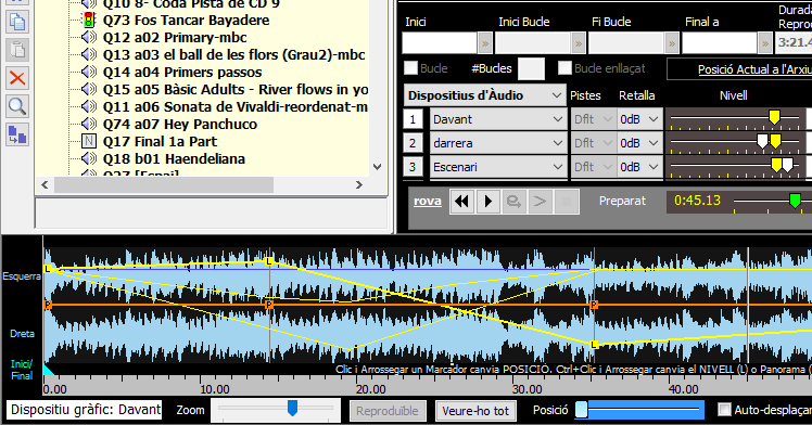

I've done this with one track sent to three audio stereo channels and editing levels on each channel.
You can see three yelow lines in the attached image.
Multichannel fade.PNG (42.02 KiB) Viewed 4286 times
This is not the real show where I used it, its only a fast setup for demo.
