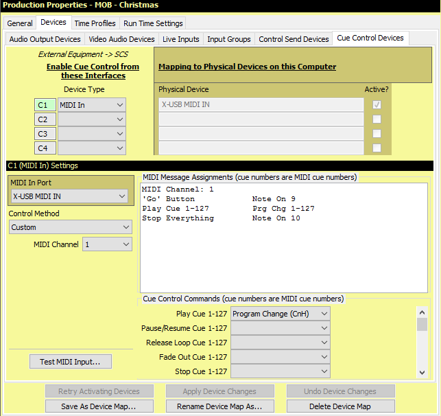

Steve, that appears to be correct when using a network connection. However, if you use a USB connection to the X32 (which you may already have if you are using the X32 as an Audio Output Device in SCS) then you can achieve this using MIDI cue control.
For example, in a recent production I set up a Cue Control device like this (scroll down the image if necessary):
On the X32 I used buttons 9 and 10 in Set C for 'Go' and 'Stop Everything' respectively, with button 9 set to send MIDI Note On 9 and button 10 set to send MIDI Note On 10.
But what really applies to your request is button 11. In my SCS cue list I have a hot key cue to 'fade out all playing cues'. This hot key cue is assigned to Key F but I've also assigned it a MIDI Cue Number of 99. On the X32 I have set up button 11 as MIDI Push, Pgm Chg (Program Change), Channel 01, Value 99.
Now when I press button 11 in set C on the X32, this activates my SCS hot key cue to fade out all playing cues.

There is one more setting you may need to change on the X32. Under Setup / Remote, set MIDI Control Interface to 'Card MIDI'. This is because MIDI will be sent via the 'USB Audio Interface' connection, which is the 32-channel card (not via the 'Remote Control USB port). I don't have any of the MIDI Receive or MIDI Transmit checkboxes selected.

Mike Daniell wrote:In my SCS cue list I have a hot key cue to 'fade out all playing cues'. This hot key cue is assigned to Key F but I've also assigned it a MIDI Cue Number of 99. On the X32 I have set up button 11 as MIDI Push, Pgm Chg (Program Change), Channel 01, Value 99.
I know I'm probably missing something obvious here, but how/where do you assign a MIDI cue number to a hot key??
S
Re: X32 Cue control and Hot Keys
Post by Mike Daniell » Sun Dec 27, 2015 12:30 pm
See Cue Properties in the Help. The MIDI/DMX Cue Number should be visible if you have set up the MIDI Cue Control device under Production Properties.
