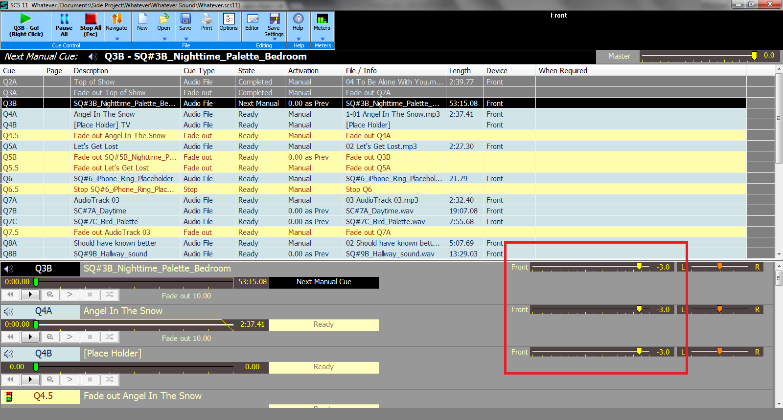

Is it possible, I feel like this worked in a previous version, that when in Design Mode when I change the volume while the cue is playing it doesn't revert back to its original setting? As it stands, as soon as the cue completes, or I stop it, it will go back to the original level. It might be a setting I've missed, please excuse my ignorance.
Thanks so much!
Currently I'm running on 11.8.8 with Windows 7 Pro.
Volume Fader in Design Mode

Does 'Save Settings' in the toolbar provide what you want?
Re: Volume Fader in Design Mode
Yes, that's it! Is it possible to have it default to save changes made while in Design Mode?

Yes, I could add an Editing Option to provide this.
