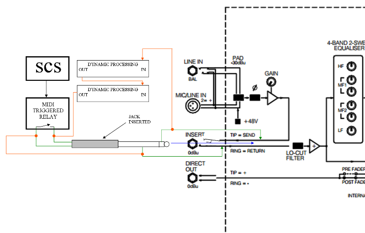

Hi sjwicks, eric and anyone else interested in this project
Would this work?

No, it wouldn't. As drawn you have the output of the second processor going to the send of the insert, not the return.
When you redraw this you need to have the TIP (or console SEND) of the insert cable going to the input of the first processor.
The midi triggered relay break should be between the output of the second processor and the RING (or console RETURN) of the insert cable.

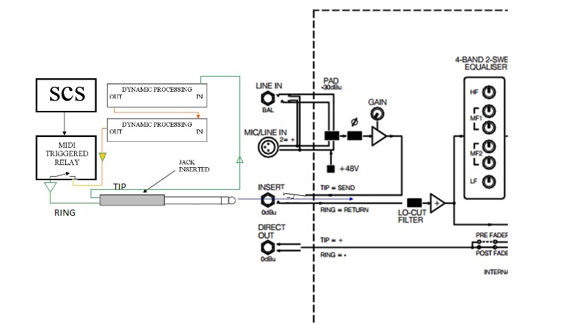

In other words, this -
Eric Snodgrass
Posts: 224
Joined: Wed May 21, 2008 4:01 am
Re: midi control sends via usb
Post by Eric Snodgrass » Tue Sep 23, 2014 3:35 pm
In theory the above schematic I edited should work but I have no idea if it will introduce an audible pop into the channel.

During the early testing of my system I did notice a "pop" each time the relay switched over. Hence the addition of the other components to prevent this. From memory these components cost less than £1.00 per chanel and I had space in the box to accommodate them.
sjwicks
Posts: 52
Joined: Wed Sep 16, 2009 10:08 pm
Location: Bromsgrove, UK
Post by sjwicks » Tue Sep 23, 2014 6:53 pm
Just had another thought.... The "popless mute circuit" will not work on a unbalanced cable this is because this circuit essentially just shorts pin 2 and 3 one of which is not present in the insert return cable.

Nice job, Eric! Beautifully simplified. Thanks.
Re channel 'popping' - I'm off on a Google of 'unbalanced audio switching suppression circuitry' - or something like that, unless either of you have (has?) any genius thoughts on that.
