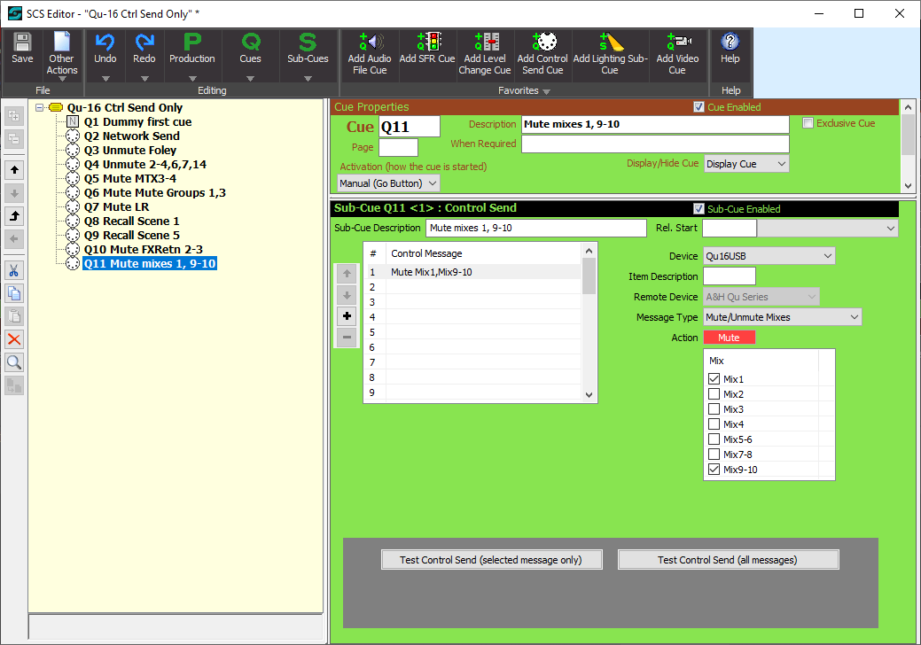

Following up on my earlier posting about modifying SCS to simplify the cues for certain external mixer actions (such as muting/unmuting mic channels), sometime next week I expect to have a pre-release available of a version of SCS that will include this feature. This will use a supplied external file that contains command formats for various mixer operations for various mixer types. This external file will be distributed with SCS, and updates to this file may be separately distributed as additional operations and mixer types are included. Initially I have just included support for A&H Qu and SQ series mixers, using the MIDI interface. Once this is confirmed as stable I will add other mixer brands, etc, to the supplied file. If you are interested in testing a pre-release of this new version and have an SCS Professional Plus or higher license, please contact me and tell me what mixer you are using. Here's a screenshot with an example of setting up one of these cues.
