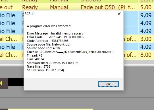

I've tried to set up companion with SCS, but it crashes whenever I press a button on the Streamdeck. Does anyone have any input on this?

A log file will have been created and saved in a folder named "SCS Logs" under "Documents", and the name of the file includes a time-stamp indicating when the log started. Please email the log from this run to support@showcuesystems.com.

Fix ready for SCS 11.8.0.2. The fix is for this bug:
  • If the Remote App Interface in SCS is used for controlling SCS from a device other than the official SCSRemote app, and if the Network Protocol is set to UDP, then SCS would crash on trying to echo data to the device.
