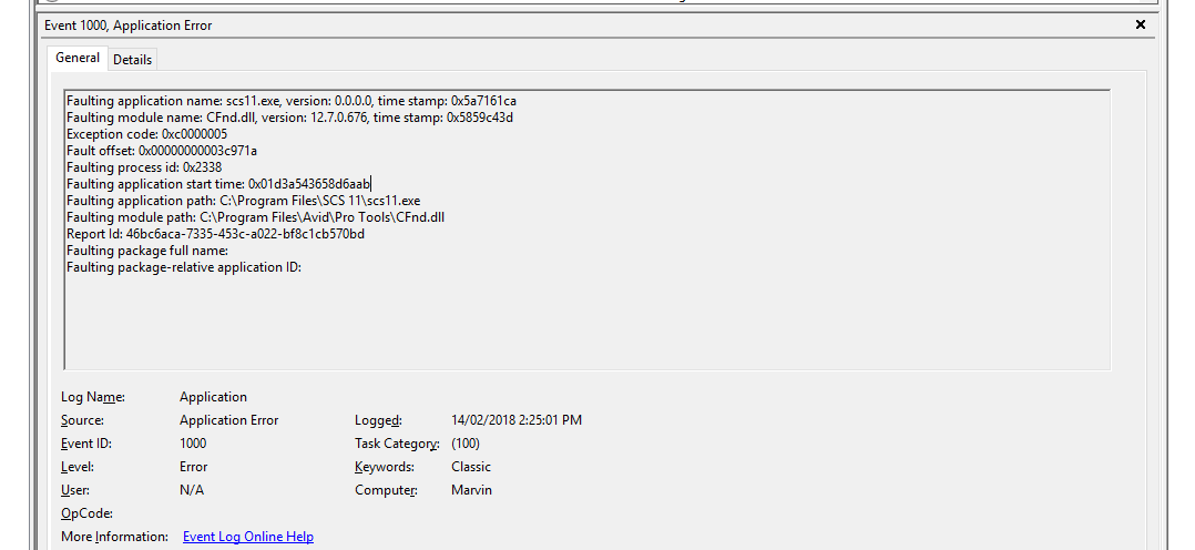

I have just installed SCS (11.7.0 RC6) on my brand new computer. When I tried to run SCS for the first time I was surprised to find that it crashed, just after loading the splash screen. Surprising because it had never happened before and I have always found SCS to to be very stable.
Checking the fault log, the faulting module name is C:\Program Files\Avid\Pro Tools\CFnd.dll
Looking around the webs, it seems that a similar problem can occur in Wavelab and Vegas (I don't have either). I tried the Vegas solution which is to rename CFnd.dll so as to "hide" it from SCS. And it works! With no CFnd.dll around, SCS now runs just fine. If I want to use Pro Tools I, obviously, have to re-name the DLL to make it available once more.
I suspect that there might be a deeper problem at work and will continue to try and work out what might be wrong with the way my computer is set up.
In the meantime I hope this might be of interest/use...

SCS does not directly call CFnd.dll and I'm not aware of any subsidiary process that would do so. However, I suspect the fail is occurring on trying to initialize an ASIO driver. I tried to email you with details of a tracing version to run, but the email bounced.

Just following up on this I think I might have come across a more permananent solution at https://www.steinberg.net/forums/viewtopic.php?t=119096
I have used HomePlayer's procedure and removed digiasio.dll from the \System32 folder and kept the file of the same name in the \SysWOW64 folder.

In my case, I can now either open SCS or Pro Tools (v 12.7.0) without having to first disable/enable any DLLs - yay!
(And CFnd.dll can stay untouched in the C:\Program Files\Avid\Pro Tools\ folder.)
