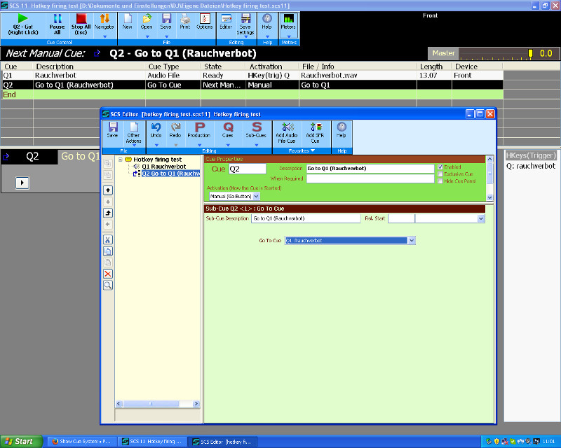

Re: Subroutine Cues
Hello at all,
You can fire a Hotkey Cue by pointing a Goto Cue to it, like this:
HTH Jörg
HTH Jörg
- hotkey firing test.jpg (130.4 KiB) Viewed 24822 times
Re: Subroutine Cues
Firing a hotkey with Goto changes the next manual cue position as well. An obscure work around which is fine for "small" subroutines is to use BOME Midi Translator (or equivalent) which can convert midi messages to key presses. So you create a hotkey cue to execute your subroutine and then send a midi message out of SCS to BOME (via a virtual midi port), which creates a key press to execute the hotkey cue leaving the next cue pointer in the right place . . .

Re: Subroutine Cues
Hello at all,
Of course "Goto" will change the cue position. One can use more gotos, which will create something, what programmers call "spaghetti code".
Anyway, subroutines would be usefull, because plays like "Intimate Exchanges" exist.
My father used to describe such things as "shooting from the back through the breast into the eye"rborsey wrote:An obscure work around which is fine for "small" subroutines is to use BOME Midi Translator (or equivalent) which can convert midi messages to key presses. So you create a hotkey cue to execute your subroutine and then send a midi message out of SCS to BOME (via a virtual midi port), which creates a key press to execute the hotkey cue leaving the next cue pointer in the right place . . .
