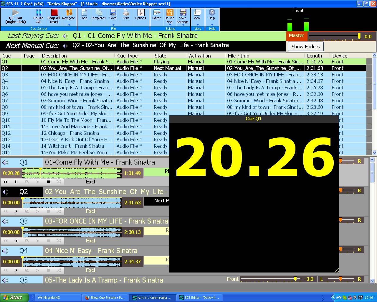

something like in the picture?
In the editor, open the "Run Time Settings" tab, under "Give Visual Warnig" select "Cout UP whole cue" and the proper time format. When running a cue, the window to be seen in my screenshot appears. It can be resized and moved to the second screen, both will be memorized by SCS.
