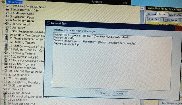

SCS 11.10.7
SCS is receiving the following commands ok and executing…
/ctrl/go
/ctrl/gotop
But if I send …
/cue/go ,s x
/hkey/go ,s
These are received but not executed.
To test further I connected 2 laptops running SCS and used the “test network control” on the receiving laptop to see what was being received. See image.

Please email us the log file from the run in which this happened. Log files are saved in a folder named "SCS Logs" under "Documents", and the name of each file includes a time-stamp indicating when the log started. Email to support@showcuesystems.com
