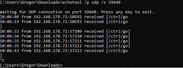

I am trying out controling SCS on a different PC for our theater play next week. However the control command is not received.
I have verified that the UDP control command actually arrives at the other PC (using a echotool - see screenshot). Also SCS seems to open the correct UDP port because it complains when the echotool still blocks this port.

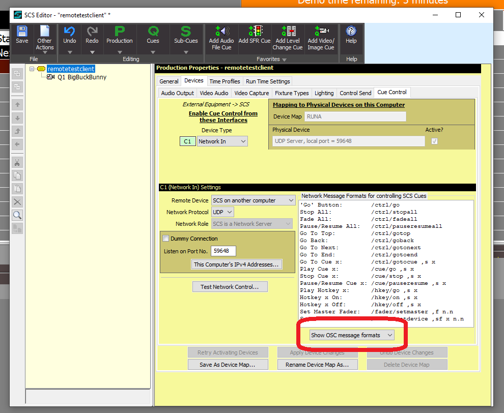

However, when i open the 'Test Network control...' window it stays empty and does not show control commands sent over. See second screenshot for configuration.
Anything I am doing wrong here?
echotool receives the UDP command
Screenshot 2024-11-13 121544.png (21.72 KiB) Viewed 9279 times
setup in SCS with no
Screenshot 2024-11-13 100250.png (83.52 KiB) Viewed 9279 times

What application do you use to send the encoded OSC messages? Have you tried sending ASCII messages? You can switch to view ASCII messages via the menu in the red circle below.
