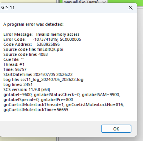

Hi Im Max,
My Scs crashes every time i try to create a lighting cue, after i prepared all fixtures and lighting devices it says error: "invalid memory access" when it tries to load my fixtures so im not able to create lighting cues :/ can you helb me?
i used scs 11.9.8(x64) first,
then updated to scs 11.10.2(x64) but it didnt change or solved the problem .
thank you for your help
max

Hi just to note that both the log files were using version 11.10.2, is that what you wanted to post?
- Posts: 3629
Re: "invalid memory access" error when creating a new lighting cue in editor after preparing fixtures
I've done quick test here and it works OK. Please email the log file scs11_log_20240705_202622.log to support@showcuesystems.com.

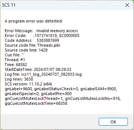

so here is a screenshot and a logfile of the same error happening just right now. both belong together this time .
thank you for help
Hi Max, we have apossible solution for you to test, can you please send an email to support@showcuesystems.com and I will provide you with a link to a beta version for you to try.

Awesome ! The Version you´ve send me works. No Memory error anymore .
Thank you for that awesome support.
cheers Max
