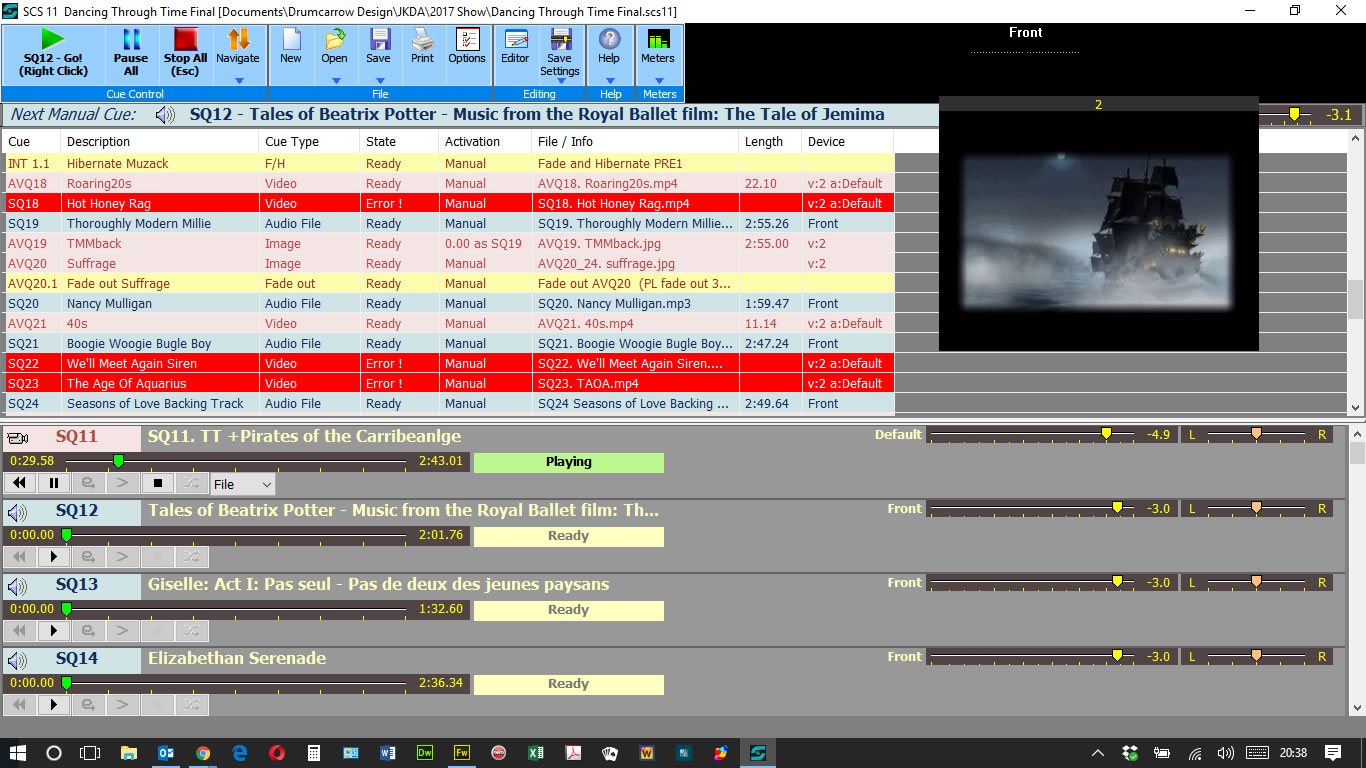

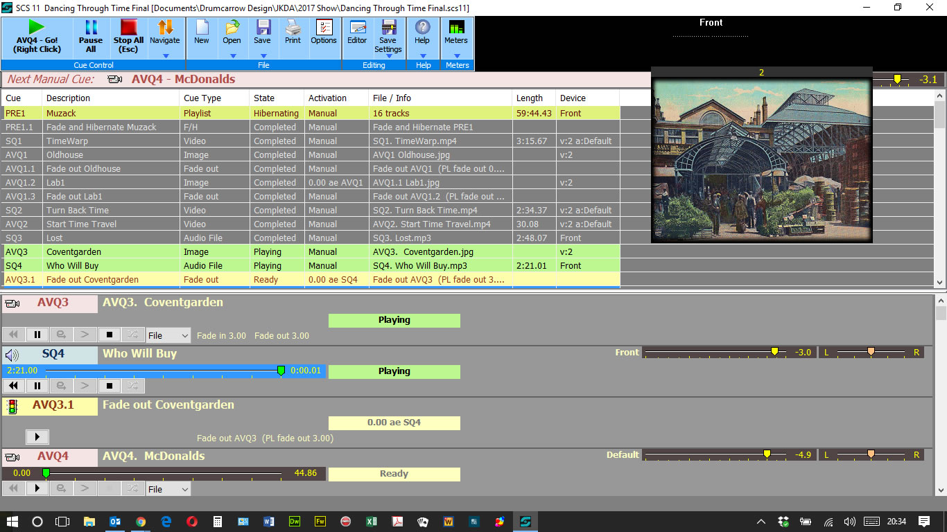

I'm running a dance show with a mix of Video and audio cues that start off OK on load and then, part way through I get video cues showing:
"Error: Rendering File Failed: 262722"
Mid-Show there doesn't appear to be anything I can do other than stop and reload the .scs file and start from where I left off.
As I have hibernating cues this is troublesome to say the least.
Some cues are also not completing leaving 0.01 secs to go and just freezing.
I have attached the diagnostic as requested.
SCS 11 Highlighted Frozen Cue.jpg (234.5 KiB) Viewed 759 times
SCS 11 Failed Render Screen shot.jpg (251.15 KiB) Viewed 759 times
