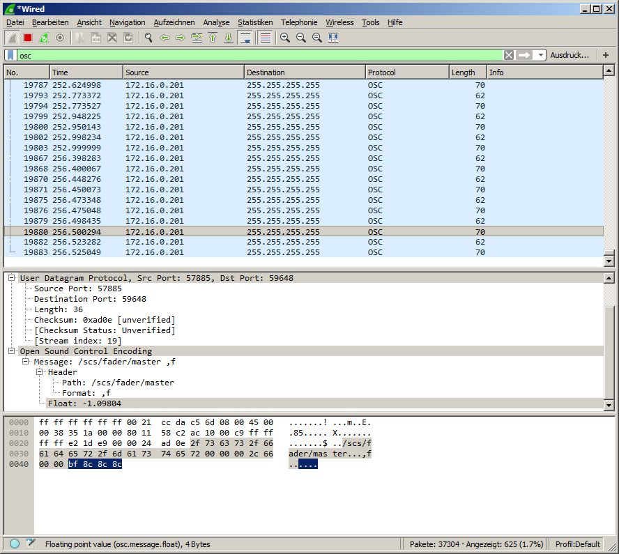

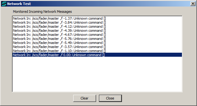

I'm trying to control the master fader of SCS with OSC. However it's not working and in "Test Network Control" SCS shows "Unknown command []". Also tried /fader/master, not working either.
Tested with Version 11.5.2.3 x64. /scs/ctrl/go works.
Attached is a screenshot of a Wireshark Capture and the dissected OSC packet.

That seems to be a documentation error. Please try /scs/fader/setmaster.
