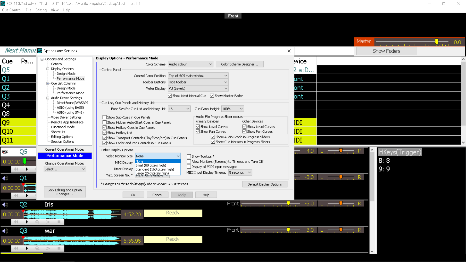

Have you tried to choose "none" under Monitor Size - Display Options - Options. See attached printscreen.

I set display size to "none" in both Design and Performance modes. Restarted SCS. But thumbnail is still there.
