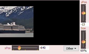

Now consider the Size and Position sliders shown here:
These sliders do not show a white marker, but if you want to reset an individual slider (eg the xPos slider) to it's default position then you can Ctrl/Click anywhere in the slider and the slider will snap back to the center position (which is the default position for all the sliders shown in this example).
