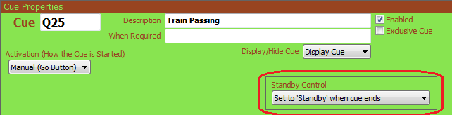

The purpose of the Standby feature is primarily to allow you to repeat the last cue. However, this is not a universal repeat last cue facility - you need to nominate which cues will require this feature when you prepare your cue file. The Standby requirement is set in the Edit Cue window, eg:
If you select Set to 'Standby' when cue ends then when the sound cue has finished playing the sound file will be left open and the State will be set to Standby instead of to Complete. Also, a Standby Go! button will be displayed in the Main Window Toolbar.
